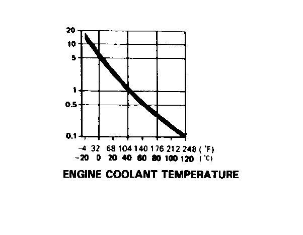

Originally Posted by Oscar McFly
If it was a sensor, shouldn't the check engine light, light on? Is the case for a code flash, without the chk engine light coming on?
Maybe not. If the sensor just had out-of-spec high resistance (but not completely open) when hot then the computer would just think that the engine was cold, dumping in too much gas on a hot start. KΩ scale:
