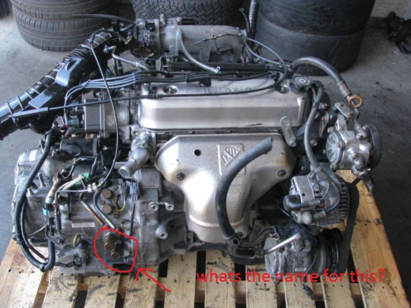

Well someone told me it was a sensor the plug that got wet witch goes to gears 3 and 4 on the transmission any one knows what its called the d4 gave me 7 then 8 one long one Nd a 4 what does that mean ?

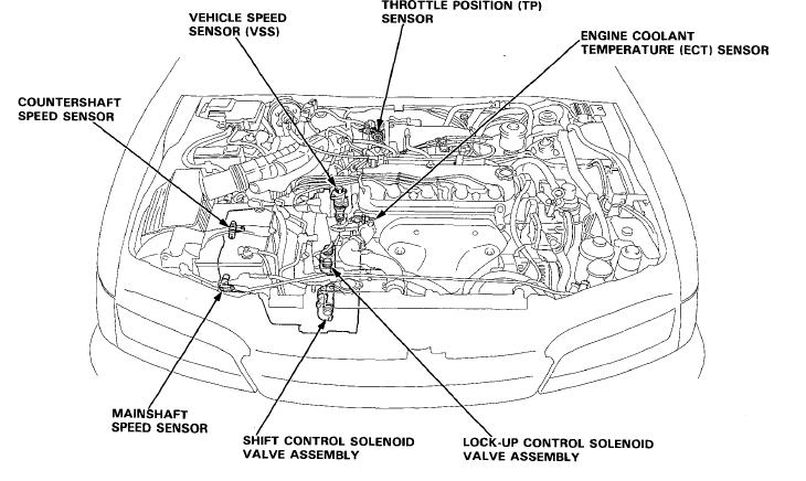

The lower is shift,,,,,the 14 concerns me?
