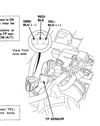

What are the wire colors going to the TPS?

They are green and white

First there should be three wires?
But it is sounding like the TPS and MAP are switched.
Please add your car info to you signature wo we don't have to go back to the first post to know what car this is....THANKS

I swapped the plugs they were crossed car drives I did new plugs it just won't. Rev past 3500 rpm now? Still feels like a dog
