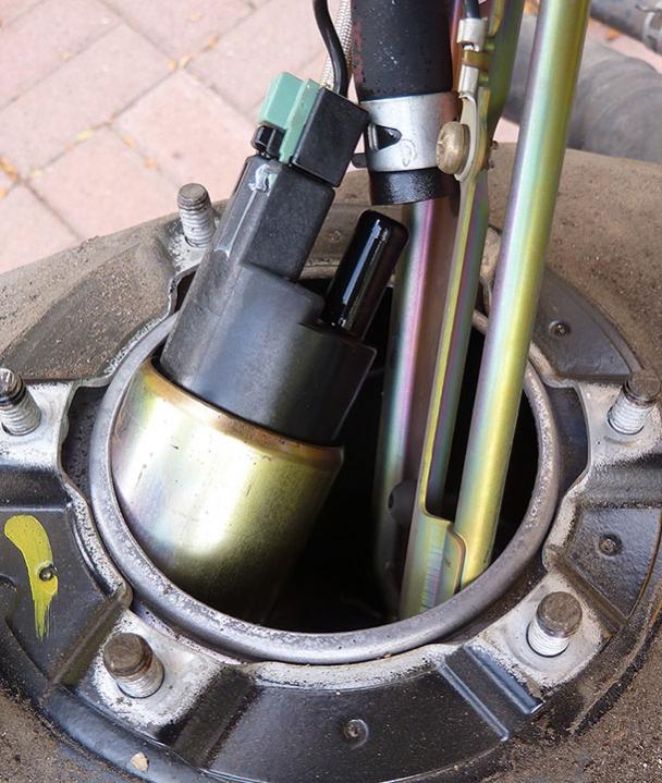

Been awhile, but I got back to the no-go Honda and found a very strange answer to the puzzle. I dropped the tank and was pulling up the pump but it wouldn't come out easily, so I looked inside and the pump was completely off the bracket and barely attached to the output hose! It all pulled apart completely as I lifted it through the top of the tank. When did this happen -- and why? And why now? Has it been like this since it was installed? It's #AF195130-2580, which looks like a Honda pump. There's at least a 1/2" of hose (and a clamp) that should have been attached to the pump output -- how did the pump pull out of this -- or stay attached in the first place? It explains why I was only reading 10# of pressure because the rest was dumping back into the tank. WTF?
Also, with everything accessible, should I replace the pump or anything else? Any aftermarket pumps to use or avoid, or are they all the same at this point?
And to anyone who's stayed with this saga long enough to reach the end: Thank you! I have a mechanical solution, though definitely not an explanation, but it's one more question and answer for the Honda troubleshooting gurus.
Attached is a photo of the pump coming out of the tank. At this point, the pump has pulled off the hose and is completely loose.

The fuel pump sits in the bracket that is attached to the upper flange closure. Looks like it was mis-assembled by someone who removed/replaced fuel pump. Hopefully no parts are left in tank!
