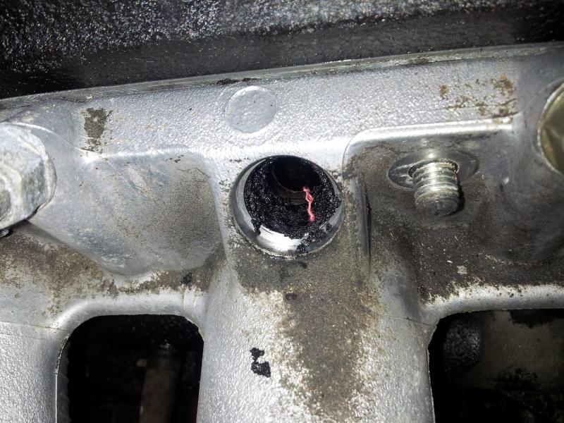

Though it took me a little bit to get the plugs off of the fuel injectors, and one of the metal clips snapped off and disappeared, it has been fixed!
I cleaned the EGR passages, and were they ever clogged. So clogged in fact, there was a small mound of carbon build up. It took a good 20 minutes just to clean the passages and the gasket themselves.
The fuel injectors, and the fuel injector ports were absolutely covered in carbon, so I cleaned those as well. All of the O-Rings were in good condition, which is definitely a plus. Ahh, there's nothing like having a normal idle again!!!!!

Took it for a test drive and there's still a flat spot in third and fourth gear. I'll be replacing the fuel injectors and checking the solenoids to cover all my bases.
