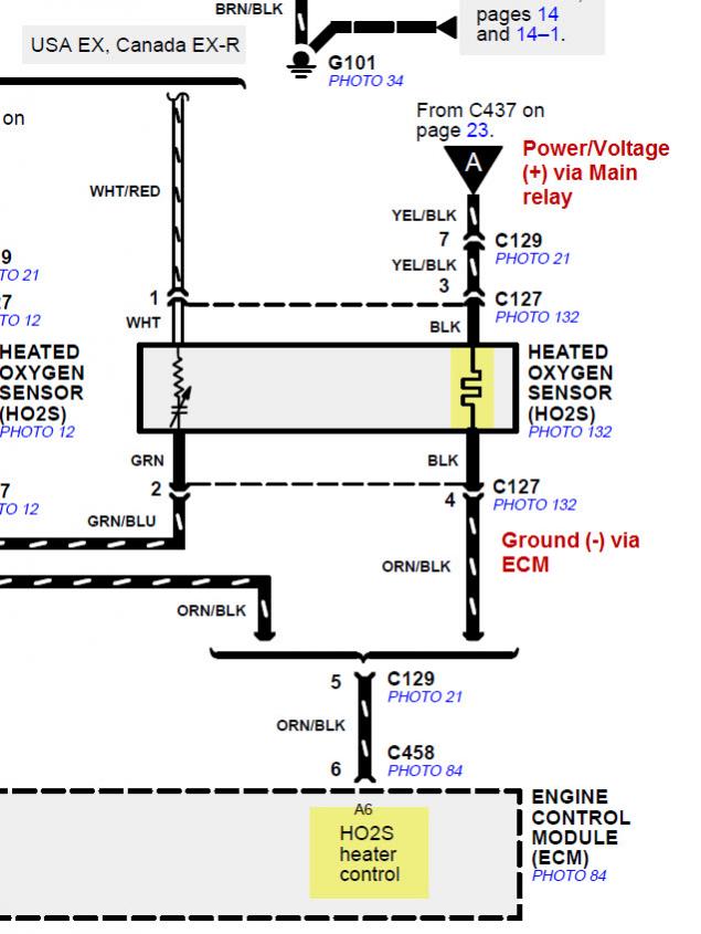

The ECM (car's computer) provides the ground (-) to the heater circuit of the O2 sensor. The main relay provides the power/voltage (+) to the heater circuit. Why would the ECM need to be replaced if the heater side of the O2 sensor did not get voltage (+)? I could understand if it wasn't getting the ground source from the ECM.
I've attached a partial circuit diagram image with a few notes I added.
Attached Thumbnails 94 ex oxygen sensor no power at connector-heated-o2-sensor.jpg

The O2 sensor heater gets power from the Main Fuel Relay (yel/blk wire) and damage to wires (supply or return), MFR, fuse, or ECM fault could interupt power to heater circuit and set code 41. Procedure is to first check heater circuit at O2 sensor connector for correct resistance (10-40 ohms), if OK check wiring/connectors for correct heater resistance from ECM harness side connector, if again OK, an ECM fault is indicated.
