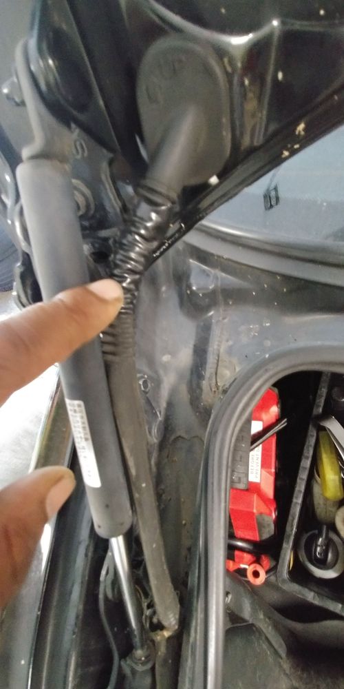

Old Sep 3, 2018 | 12:43 PM
djkurious's Avatar
Joined: Jan 2012
Posts: 211
From: Nashville, TN
Originally Posted by woody_968
I found the wires in the trunk lid. Connectors visible in two places, one right by the latch and one off to the right when looking at the car from behind. Both connectors seem to be latched tightly.
Had the same issue, traced wires with multimeter and probe light to this location and there was a disconnected orange wire inside this loom. Reconnected the wire and all is well.
