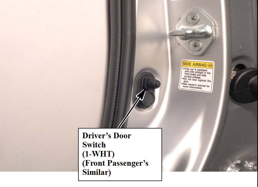

Try this, pry the cover off the passenger side door switch to expose the screw. Remove the screw, then gently pull the door switch out and unplug the electrical connector from the switch. Use something to keep the electrical connector from falling back into the hole, like some tape. If the passenger courtesy light goes off with the switch unplugged, then it is an issue with the switch.

It's raining heavy here so I won't get to it today. Yes it's a sedan and it's only the passenger side. The drivers side courtesy light works correctly.
I will give it a try and see what happens. My vehicle is still under warranty but I don't know if they would cover this since I broke it.
