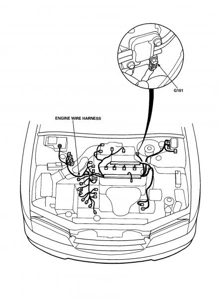

Old Mar 3, 2013 | 10:59 PM
Posts: 16,337
Sorry, thought you had a different generation accord. That important ground is on the top of the intake manifold on the driver's side of the manifold. Here is a picture:

Old Mar 4, 2013 | 03:24 PM
