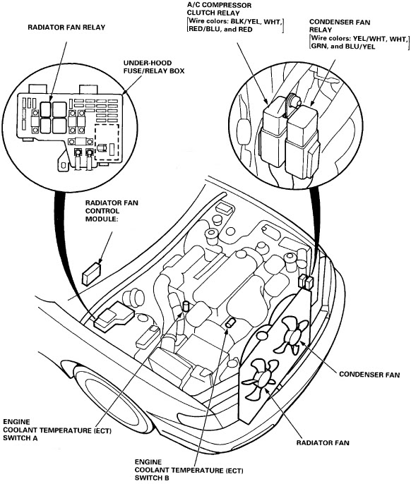

Also, both fans should always come on and run together when they do run when the ignition is on. Since the driver side fan isn't coming on unless the ac is turned on this would point to the fan timer unit being bad.
I am enclosing an illustration of where yours appears to be located. It appears to be somewhere under the dash.
It is part 13 in this illustration.

Thanks, the timer was replaced, and this is my second cd5, first was a 2door that the fans worked the same. Could be some models are different? I know mine is Japan built, not US or Canada. I don't know the precise compression specs but mine is running 1-176...2-181...3-175...4-180... I know we replaced the pistons, rods, crank, and cam for performance upgrades, I think the pistons are 9.5:1 or 10:1, can't remember which. I thought maybe the header, but was doing before. I even got a thermostat that is supposedly 18% bigger flow. I would put the old motor back in, but was replaced due to throwing a rod.
