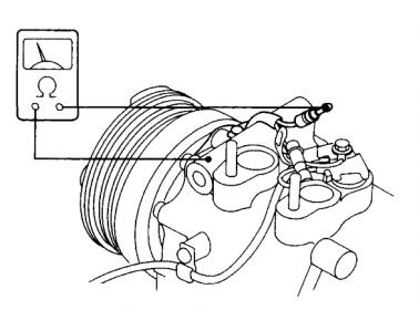

You should check the resistance of the coil (see pic). It should be 3.6 ohms.
That phillips head bolt that is shown in the picture is the ground for the compressor. You may want to remove it and sand the connection and compressor housing to make sure that you have a good ground connection.

You are testing ohms from the red wire that feeds into the clutch coil to that phillips head bolt in the picture.

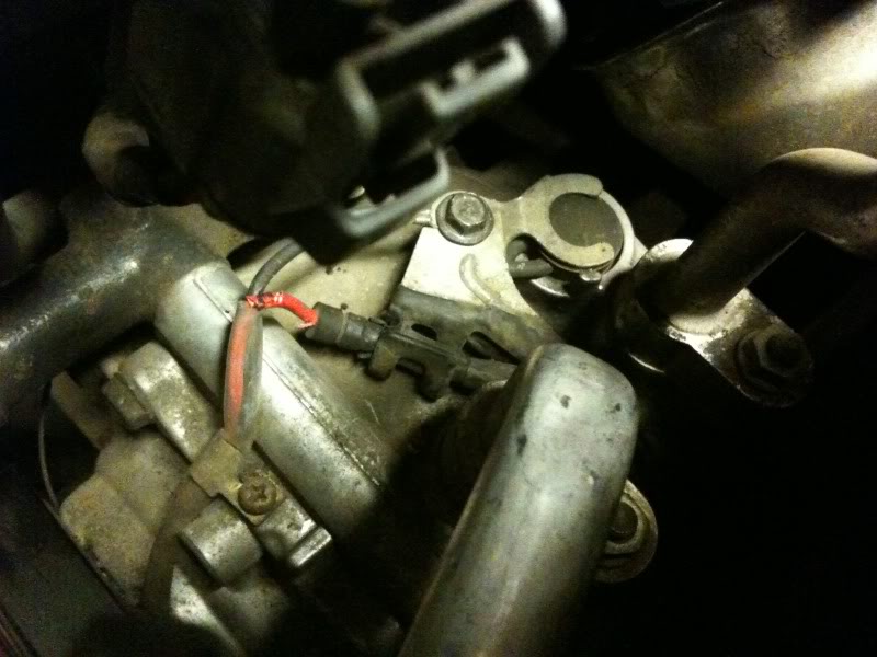

ok, this is a v6. the bolt is an 8mm hex head. i tested it and get 0. the clutch and pully both spin with the a/c on and off????

and that red wire looks worse then it really is

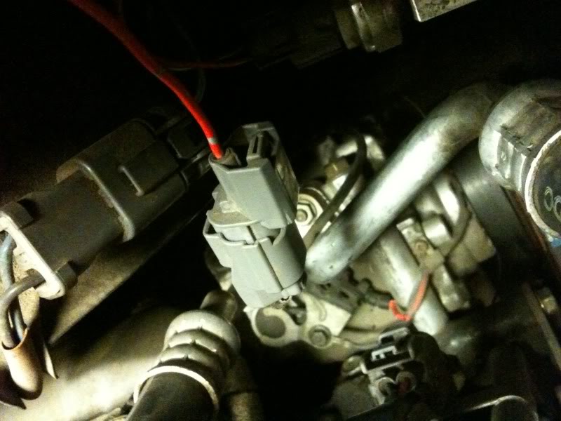

Does your compressor have a two-pin connector going to it?

1 pin that is attached to the fan shroud

I was giving you test from the 4-cylinder. The V6 is a completely different setup.
In your first picture, you want to pull that black part to the right of the red wire out of the clamp and unplug it.
Check for continuity (aka closed circuit, zero resistance) from the 1-pin connector in your second picture to the female part of the red wire that you just unplugged.
For the coil resistance, test from the male part that fed into that wire to ground. See new pic. The resistance on the V6 is 3.2 +/- 0.15
