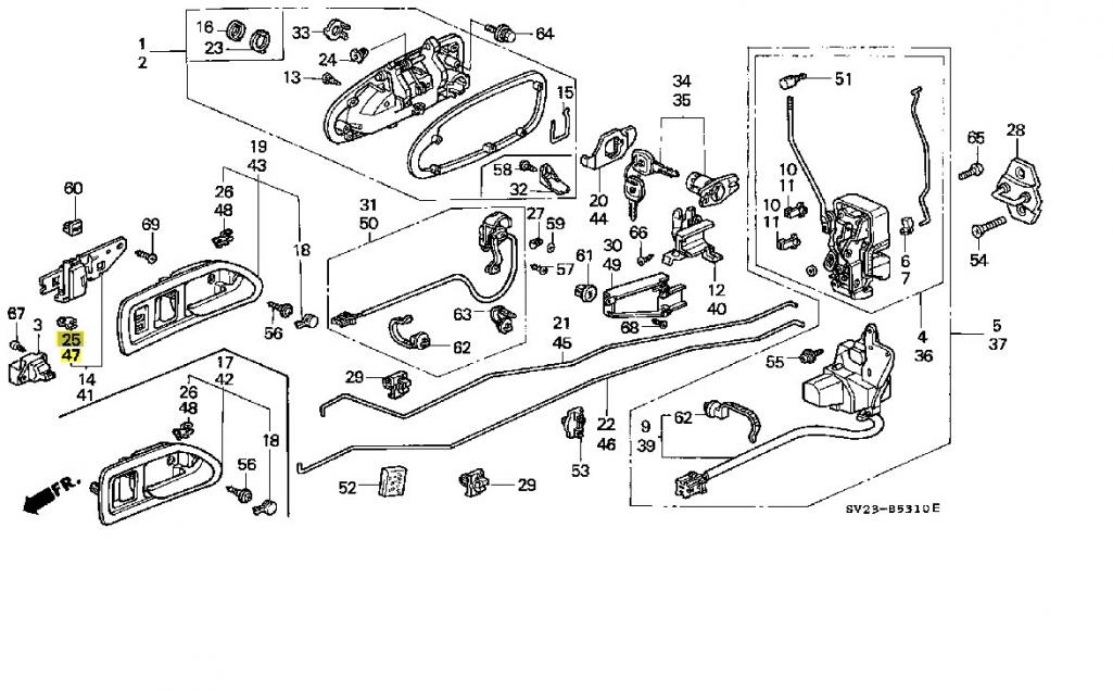

Is the plastic piece you are referring to shown in the first picture in this thread, which shows the door latch and actuator?
honda-tech.com/showthread.php?t=2465699
Or are you referring to the plastic piece (IIRC, purple color or yellowish color) on the inside door handle that the rod hooks onto?

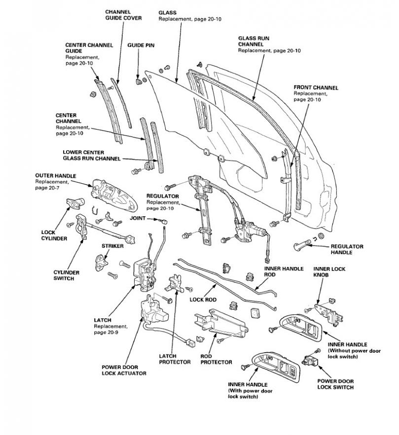

I'm still a little confused which clip. See attached pictures, are they shown in any of the pictures?
Attached Thumbnails 96 accord lx coupe lock problem!-outer-door-handle.jpg   96 accord lx coupe lock problem!-inner-handle-rod-lock-rod.jpg   96 accord lx coupe lock problem!-door.jpg
Old Oct 12, 2011 | 12:37 AM
tanhanson94's Avatar
Joined: Oct 2011
Posts: 34
okay so in the third picture i see what im talking about. if you look at the lock rod u see at the right end it kinda curves up ok, thats where it would go into the "inner lock ****" part shown in the diagram. where it goes is like behind the switch that would then be placed into the "inner handle". theres a plastic piece that holds the rod in and thats what broke on me. sorry for being such a pain haha
Old Oct 12, 2011 | 01:04 AM
Posts: 7,101
Okay, let's see if this is it. Is the plastic piece purple (violet) or yellow? If it is, then it probably is the snap. The Honda site I looked it up is mixing up the descriptions of left vs. right side door for color.
You would get this from a Honda dealer or salvage yard.
Honda part number for the purple one is 72134-SM4-003, list price is $1.88.
Honda part number for the yellow one is 72174-SM4-003, list price is $1.88.
