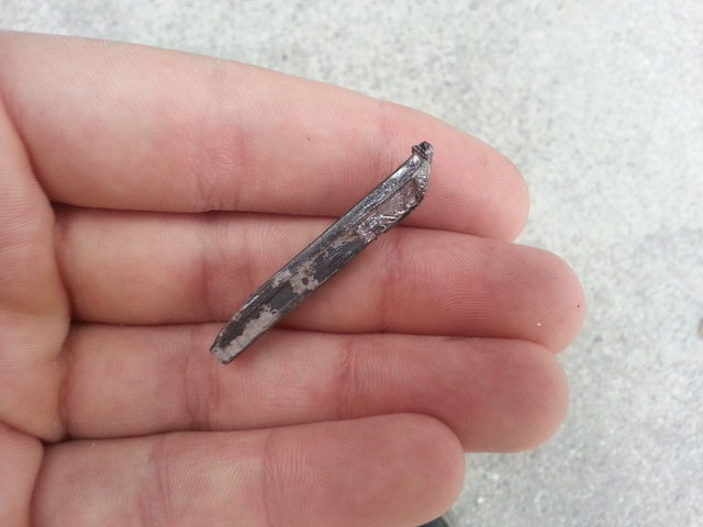

Hey looks like I was able to get the key out! I was pulling on the wrong part but now it's out.
Woodruff key:
Pulley with no key:
So I guess all I have to do now is get a new key and harmonic balancer. Is there a specific way to put the key in or does it just push in and stay secure.

Disconnect the battery so you don't accidentally try to start the car with the key removed. Do not try to rotate the engine by hand, because the timing belt will not move with the crankshaft with that key removed.
I am almost positive that the key will have one end that is flat. The other will be rounded (a half moon shape). The flat end will point away from the engine. The rounded end will point towards the engine. From your pics, I think the key may have been installed backwards.

Oh ok thanks. I can't seem to find the key anywhere online. I tried calling 1A Auto to see if the key came with the harmonic balancer and they said I would have to buy it separately.

Junkyard? These parts typically fail only when the crank bolt isn't tightened down after a timing belt job. 95% of the junkyard balancers and keys will be in perfect shape.
