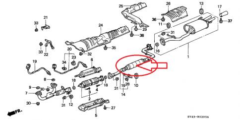

I found a picture of what piece it ripped off at as well, not like hondaautomotiveparts.com names the part =/

That part is called flexpipe. It uncouples vibration from rear pipe to catalytic cnverter. You may have damaged wiring to O2 sensors when the exhaust was damaged.

I suspect you may be prone to cracking of welds due to vibration. Welding SS410 results in brittle, fatigue-sensitive welds and absence of flexpipe will increase flexing on welds. They may not last, but you never know they may
Old Feb 11, 2014 | 12:40 PM
The part he circled isn't the flexpipe. The flexible part is towards the aft end of #7. That enlarged part is a bellows covered up with SS braid.
The part he circled is the "B-pipe" which is kinda like a front muffler with connecting pipes.
Old Feb 11, 2014 | 02:58 PM
Jim is right. I thought I remembered a flexpipe behind the converter.
