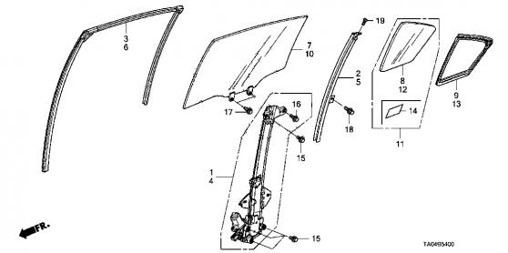

On your car the motor and regulator are installed/replaced as one assembly. The window rides up and down kind of like an elevator.
A 12 volt power source can be from things such as:
  • your car's battery (using some long wires, such as speaker wires)
  • 12 volt lantern battery (this is what I use)
  • 12 volt drill or other power tool battery
  • etc.
Attached Thumbnails One Window Won't Move, The Rest Seem Fine-rear-door-glass-regulator-469610.jpg
