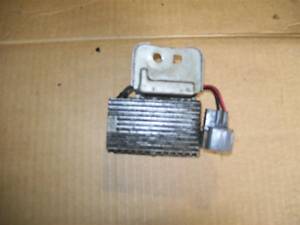

Find the injector resistor box (shown below) on the driver's side of the engine bay near the firewall. What wire colors in the electrical connector are going into that part?

Attached Thumbnails 97 accord f22b2 engine swap too 94 f22b2 wont rev past 3200rpms and starts like crap!-b7w6tj-b2k%7E%24-kgrhqmokj0eyk5zy1c-bm1j0jfs-g%7E%7E0_35.jpg
