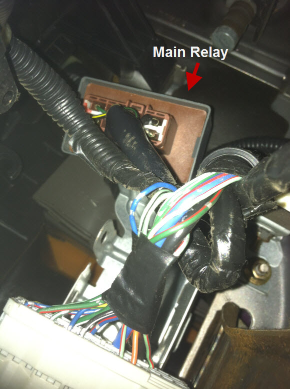

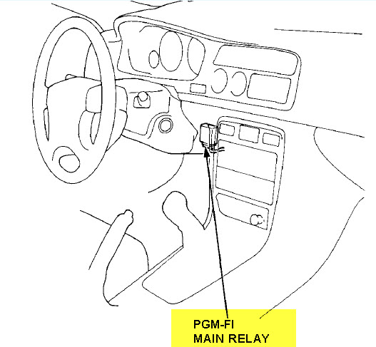

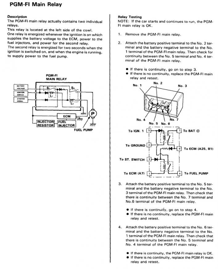

It may be the main relay or some other cause.
PGM-FI Main Relay
It operates the fuel pump and supplies power to the fuel injectors. It can fail due to cracked solder, which results in intermittent/nonexistent current flow to the fuel pump or the injectors.
How the Main Relay works
Main relay symptoms are:
Car won't start when hot.
Car does not start after parked for just a minute.
Car starts but quickly dies.
Windows have been rolled up on a hot day when problem occurred.
The heater was on before turning the car off.
No (humming) sound from the fuel pump the moment the ignition switches ON.
Check engine light comes on (rare cases) or stays on longer than usual and/or no sparks (electronic timing only.)
10-15 of waiting and the car pushed to a shade, will usually start.
Attached are pictures of the main relay location on your car and testing procedure.

I thought I tested the relay correctly but after I installed the new one my car still wont start. Doesn't matter though because I think I screwed up the original one anyways.

I didn't screw up the install, I screwed up the old one testing it. I hooked up a couple of jumper wires off the battery, put them to the proper pins and tested continuity of the other pins just like the guide said, but the wires got hot and sparked. The brief time I did have it hooked up though, my meter had no continuity reading.
