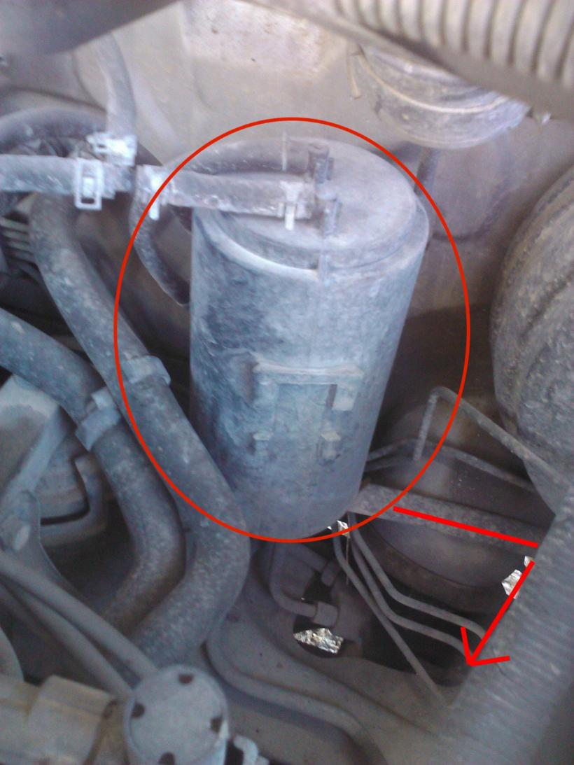

There is this canister under the hood that has a hose on the bottom of it. The hose follows the red line and connects to "something". Then another part of that hose is just dangling under the car... Where does that go?

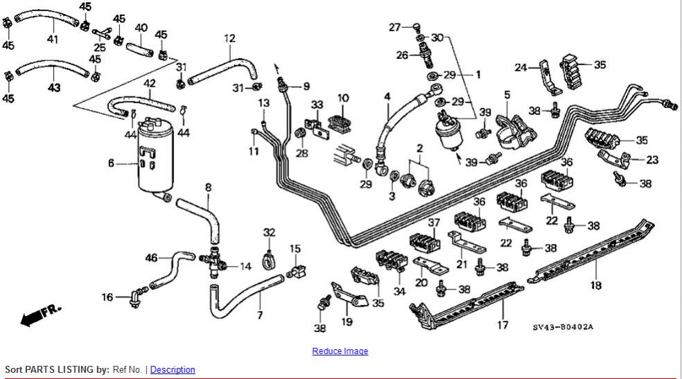

It's a drain tube, that's how it suppose to be. It's the drain tube (part #7) in the parts diagram.

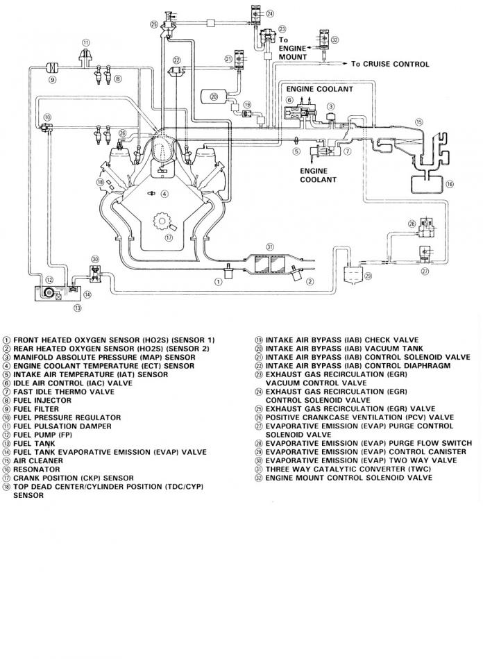

I also included some other diagrams, even though they don't clearly show a drain tube connected to the canister like the parts diagram.
Attached Thumbnails 97 accord v6 auto-canister.jpg   97 accord v6 auto-accord-v6-vacuum-hose-routing.jpg   97 accord v6 auto-accord-v6-emission-schematic.jpg

Ah okay. Thank you. Now I have to figure out why my check engine light just came on after getting my stock exhaust wielded up
