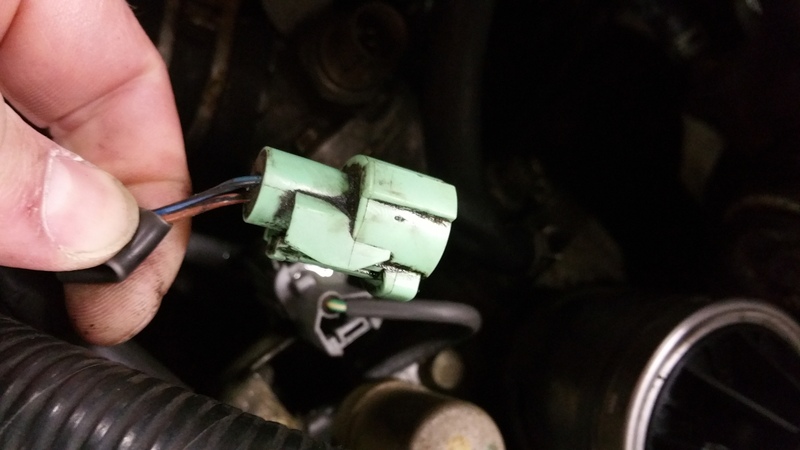

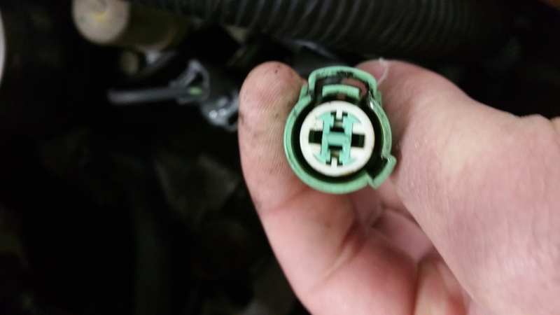

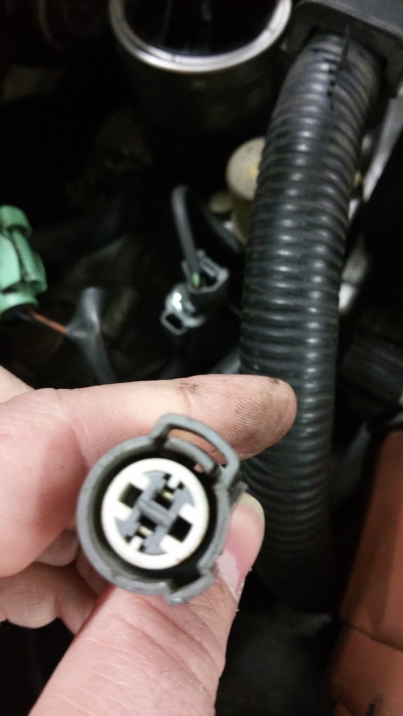

I have another question for you all. I have a couple plugs that I am not sure about on my car. Can anyone help with where they go?
1. Gray plug - Green & Black wires located in the bundle with the distributor plug
2. Green plug - Red & Blue wires located in the bundle with the distributor plug
3. Gray plug - Black with silver dots & Blue with silver dots & white stripe wires located in the bundle with the fan plug
4. Gray plug - Red with silver dots wire located in the bundle with the fan plug
Thanks for all the help you guys have given me so far.

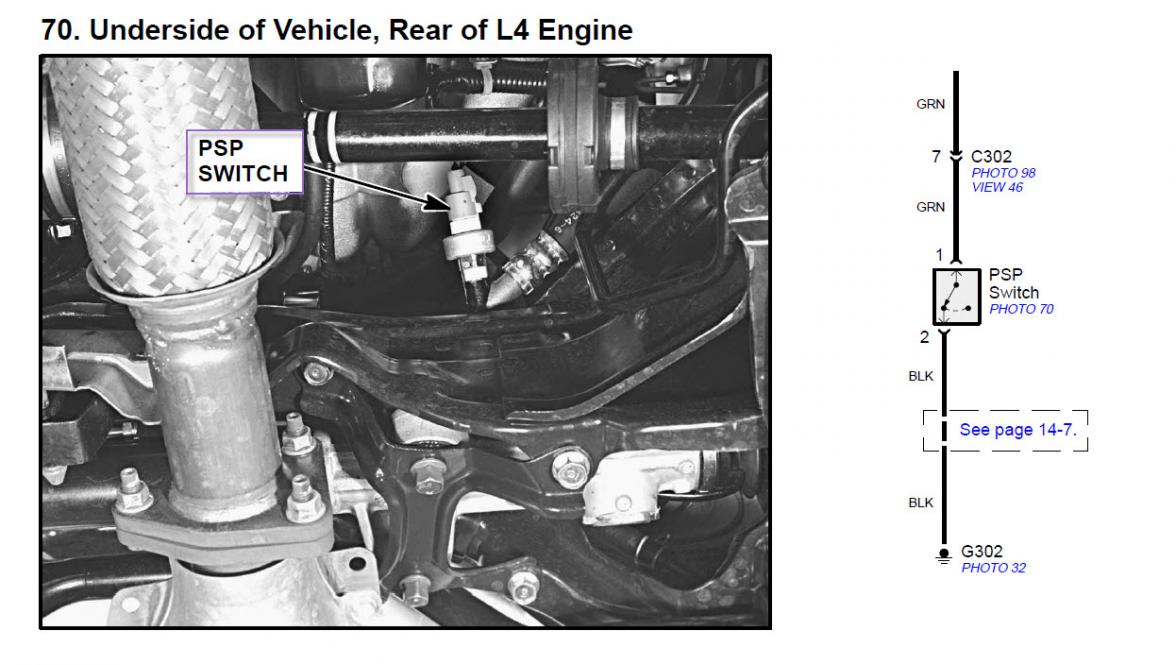

  • Gray connector with Grn and Blk wires look to be for Power Steering Pressure (PSP) Switch.
  • Green connector with Blu/Blk and Brn/Blk wires should be for VTEC oil pressure switch.
  • Gray connector with Red wire look to be for A/C compressor clutch.
Have not found the gray connector with Blu/Wht and Blk wires yet.

1. Coolant temp sensor
2. VTEC oil pressure switch
3. Larger electric fan
4. A/C clutch
here are the answers I got in the other forum I posted this.

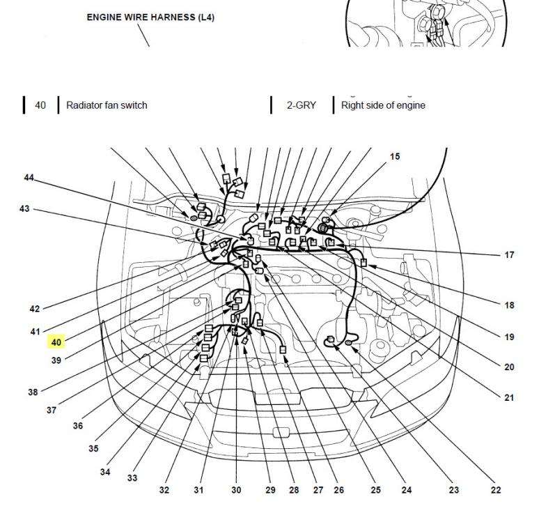

The connectors and the wire colors for both radiator fan switch and the PSP switch look similar. It is the different wire harness that differentiate them. Dorman even sells a PSP connector that looks the same as your photo. However, due to the location, yours probably is for the radiator fan switch. The PSP switch is on the power steering pressure hose, located under the left rear of the engine compartment.
Dorman Products - 645-203
Also, see various images I've attached.
Attached Thumbnails 98 Accord LX 2.3 Wiring-radiator-fan-switch.jpg   98 Accord LX 2.3 Wiring-radiator-fan-switch-wiring.jpg   98 Accord LX 2.3 Wiring-psp-switch.jpg   98 Accord LX 2.3 Wiring-psp-wire-routing.jpg
