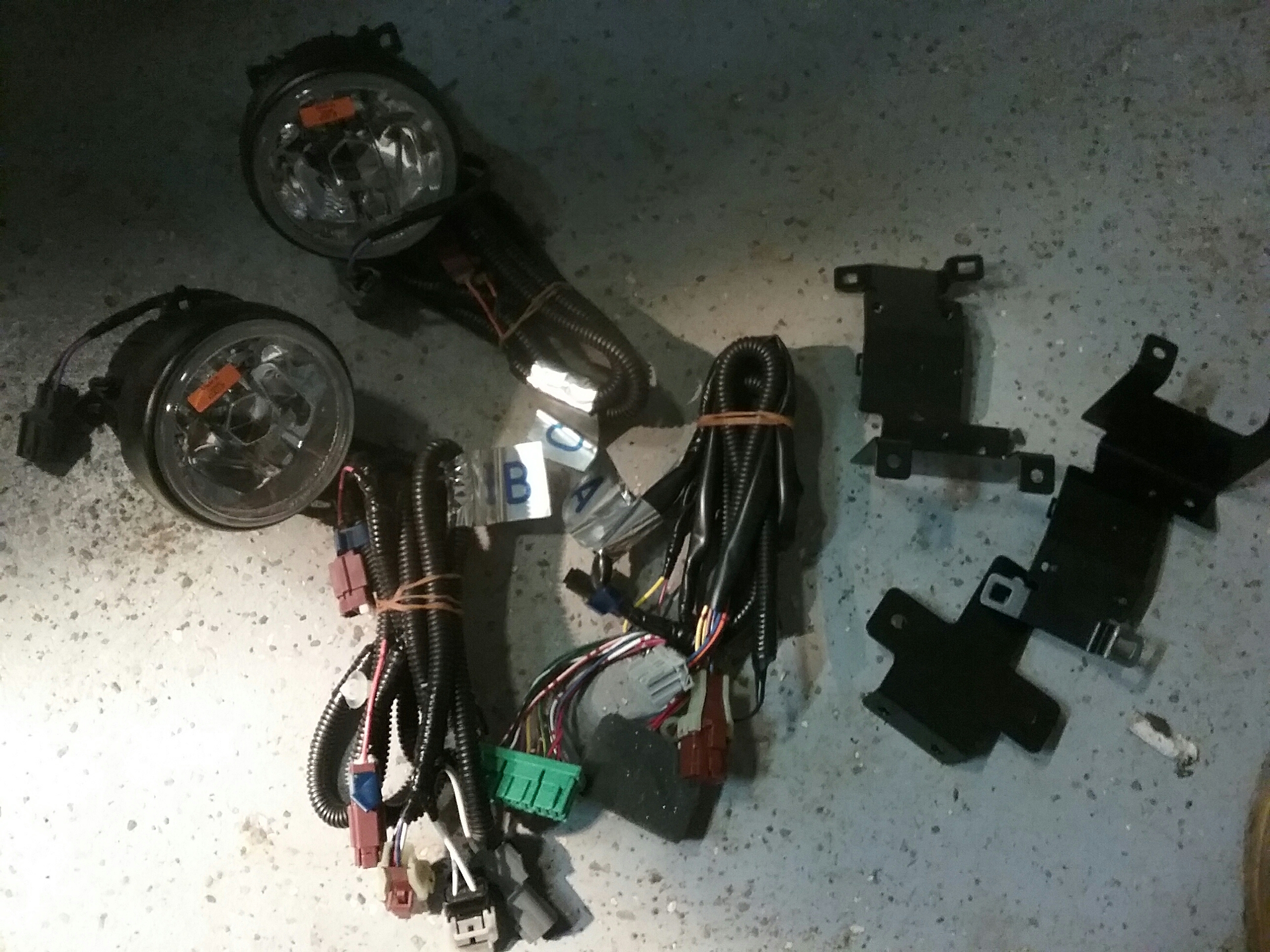

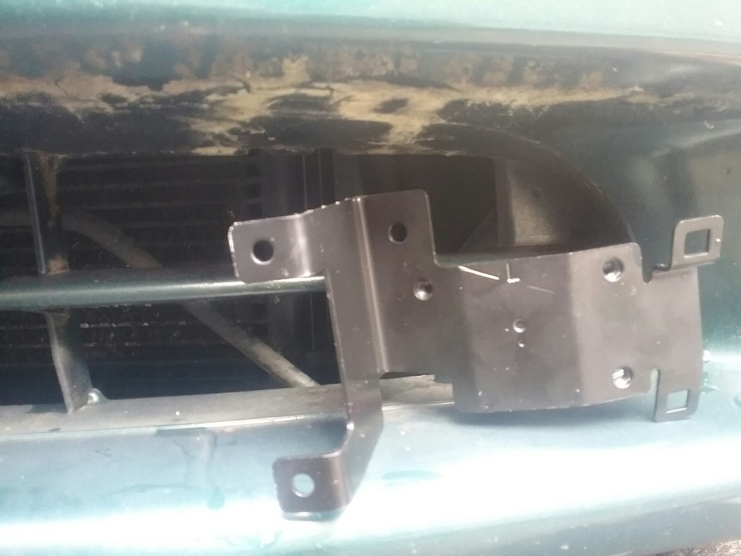

Hey guys this my first time posting and need help with fog light install. Im having a problem getting the fog light bracket bolted up. Theres no tabs for the the left side of the bracket, closet to license plate. Any clue how this gets bolted up? I have a 98 lx sedan if it helps. thanks in advanced

Those are aftermarket fog lights.
For the Honda accessory fog lights, they use an additional sub-bracket for the left side of the bracket.

These are oem fog lights i bought the set from honda years ago. Comes with A B C sub harnesses and all the hardware.

Did it have the sub-brackets like in the instructions?

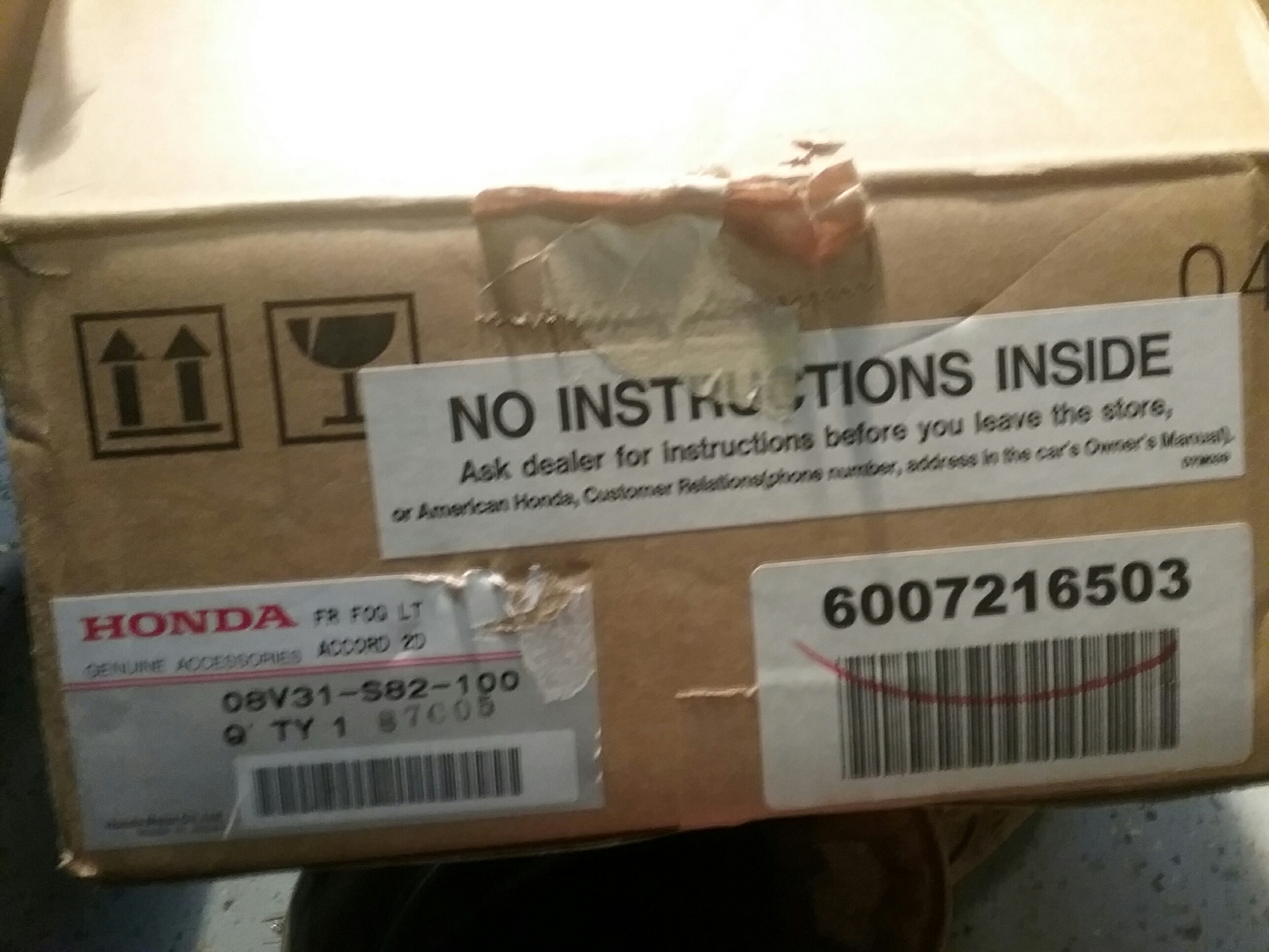

The fog lights with Honda part number 08V31-S82-100 are listed for the coupe, which is the same as the on the box in your photo.
The fog lights with Honda part number 08V31-S84-100 are listed for a sedan.
These are the OEM fog lights without the garnish, which do not require the sub-bracket. Attached are installation instructions for the fog lights without garnish. It does not require the sub-brackets.
(The previous links are for the ones with garnish; 08V31-S84-100G.)

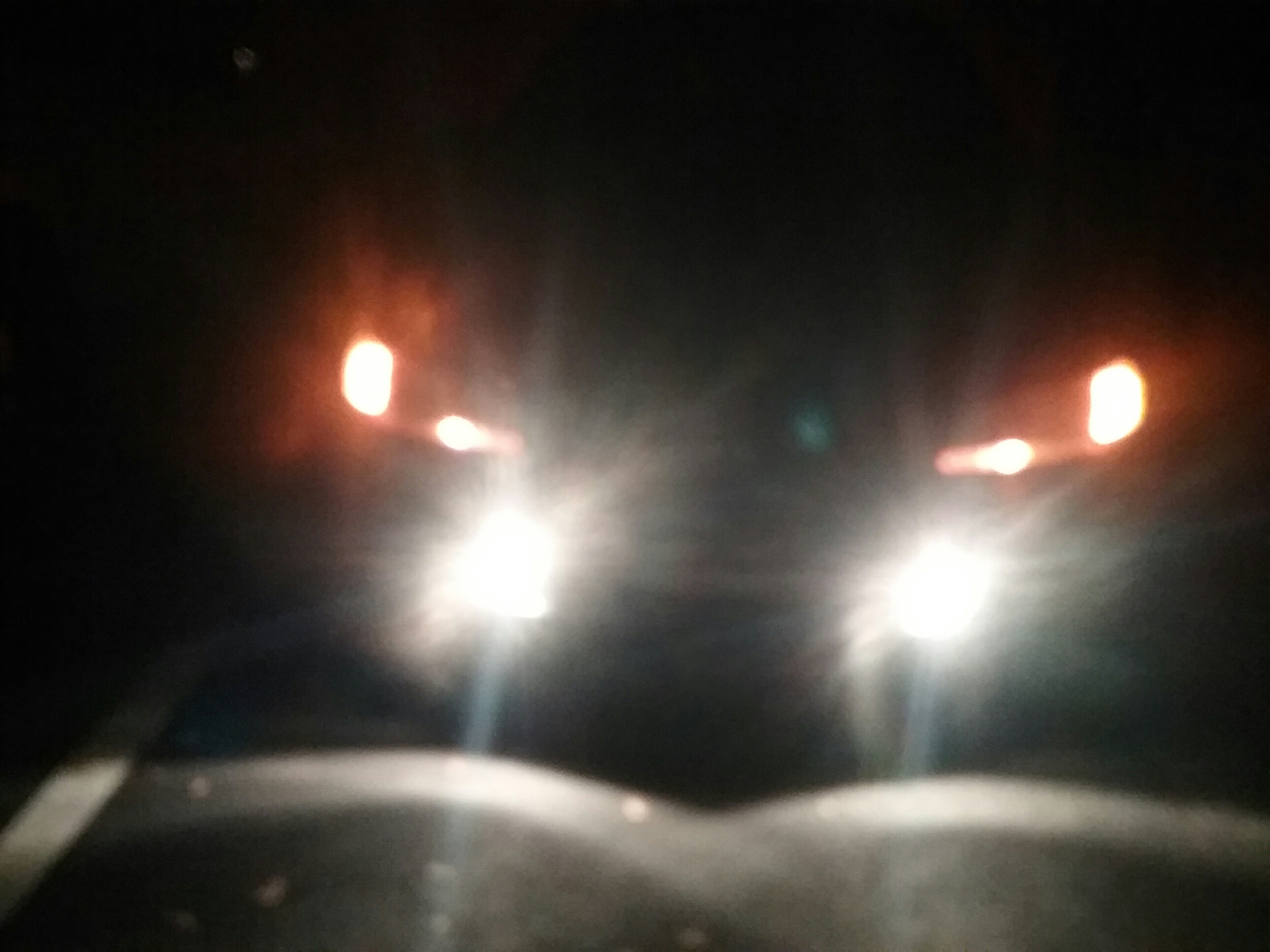

Thanks for the info install went good just wired lights to corner lights. They look great. Now time for a retrofit.
