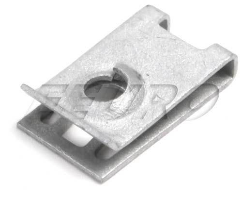

Since it's boxed in by that plastic stand-off on the radiator, it looks like it may have originally had a clip like this, and was replace with a nut during some repair. This photo isn't a Honda part, but I think this type of clip can be found at car-parts stores anywhere. Used for things like the splash pan under the engine, or fender liners, or things like that.
But that doesn't help you get the nut/bolt off in the first place...

Jim, if you look at the bolt holding the bracket, you can see the nut is still there. It's just spinning in it's clip. The speed nut clip you posted would be a good way to fix it, once he cuts the old bolt head off.
