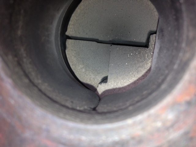

That "honey comb" is the metal......some expensive metals at that, hence the cost and why people steal them and if you recycle it you can get some money for the old one (~$100 ?).
Many reasons they fail, the most common is a rich running engine. So tune up items must be up to date, old/bad/lazy O2 sensors should be replaced.
A flashing CEL as you drive is a very bad thing. You need to have the codes addressed ASAP.

dude if the cat rattles, and the old one rattles, its a physical failure theres nothing wrong with your car.
