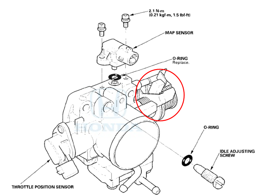

I can't find a good picture of that other adjustment screw & now I'm wondering if I remember it correctly...
It around the cable-barrels & springs for the throttle. If the cables are slack, what kind of tab or structure stops the throttle from closing even further? A screw with a locknut might have been there on earlier Accords, or maybe I just can't find a picture from the right angle.
If there's no actual screw, then a sloppy method of adjusting would be to bend the metal tab that hits against a stop. Hopefully some misguided mechanic in the past hasn't messed up that tab.
Or... What about the throttle springs being weak & unable to close the throttle completely? (I guess I'm grasping for ideas now)
Other things to check are the 2 O-rings in the picture. MAP sensor and the proper idle-air screw. If those O-rings are hardened with age & heat, they might leak. But hopefully you've ruled those out while looking for vacuum leaks.
Take out the idle-air adjusting screw & look at the tip. Is it mangled or anything? If it's not right, if it doesn't seat properly into the opening, then it might still be open even when you tighten it with a screwdriver.

I couldn't find a manual adjustment screw.
There is a definite gap between the plate and both throttle cable/shoe...there's no contact there, and the plate is some thick black material (plastic?)
As far as I can tell, the throttle plate (butterfly) is operating normally & closing fully.
The idle bleed was dirty but not deformed; I cleaned it off with no issues & blasted the orifice for good measure.
I'll have to check those O-rings...though neither the bleed screw nor the MAP unit responded to carb cleaner.
I may just disassemble the entire throttle body & start over with new gaskets. Nothing lowered the idle during my efforts...but I agree, there has to be a vacuum leak in there, somewhere. I'll keep you posted. Thanks.

How about an out-of-place O-ring on the idle adjustment screw. It belongs in the big groove near the head, so when you put the O-ring on you have to push it over the threaded part.
If the O-ring is near the point of the screw, it'll prevent the screw from closing all the way. And that won't be a vacuum leak from the outside so it won't respond to carb cleaner.
(still grasping for ideas)
Yeah the pic (drawing is deceiving) in how the "O" ring is supposed to sit on that screw. When I had the plenum split on my wife's car (I was cleaning out the EGR port), I used a new gasket, but I also added some Aviation glue to it to make sure it would seal. Having dealt with air cooled VWs over the years, I've found metal gaskets to be hit and miss when it comes to sealing.Double check the hose ends and maybe even the hoses length. I only mention it, as a buddy had a slight miss on his wife's Blazer. Turned out a vac hose ran from the left side to the plenum, and was full of minute cracks you couldn't see until you flexed it. He also found other hoses that were loose on their connectors. Little things like that add up to vacuum leaks and a miss.
