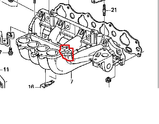

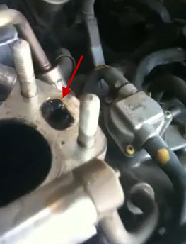

And for the p0401, yes I would pull the plenum apart and clean it, be sure to get the small little egr port. Some pic's to give you an idea of what to look for...yes I like pic's
Attached Thumbnails 99 accord mis fire/egr issue.-6th-gen-injector-base-egr-port.jpg   99 accord mis fire/egr issue.-6th-gen-4-cyl-egr-port.jpg

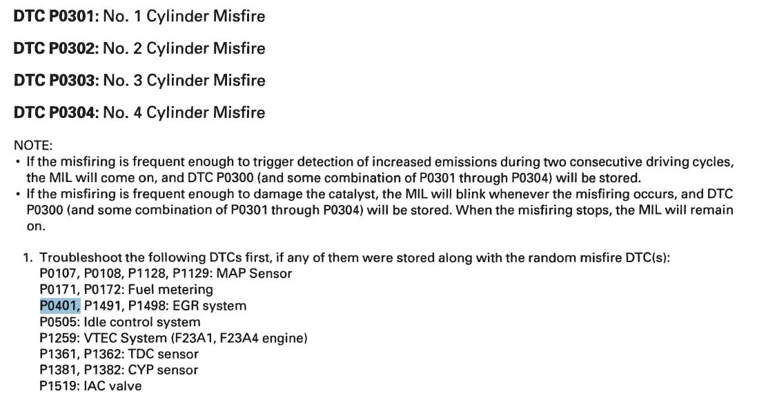

Recheck the wires to the injector and be sure that you are getting voltage and ground. Going on memory, code for lord help us all, but one is hot all the time and the ecu sends the ground when it wants the injector to spray.
Next, did you get into the plenum and check the egr port/passage.....should have said this in the PM's but the "book" says to address the 0401 before worring with any missfire codes.
