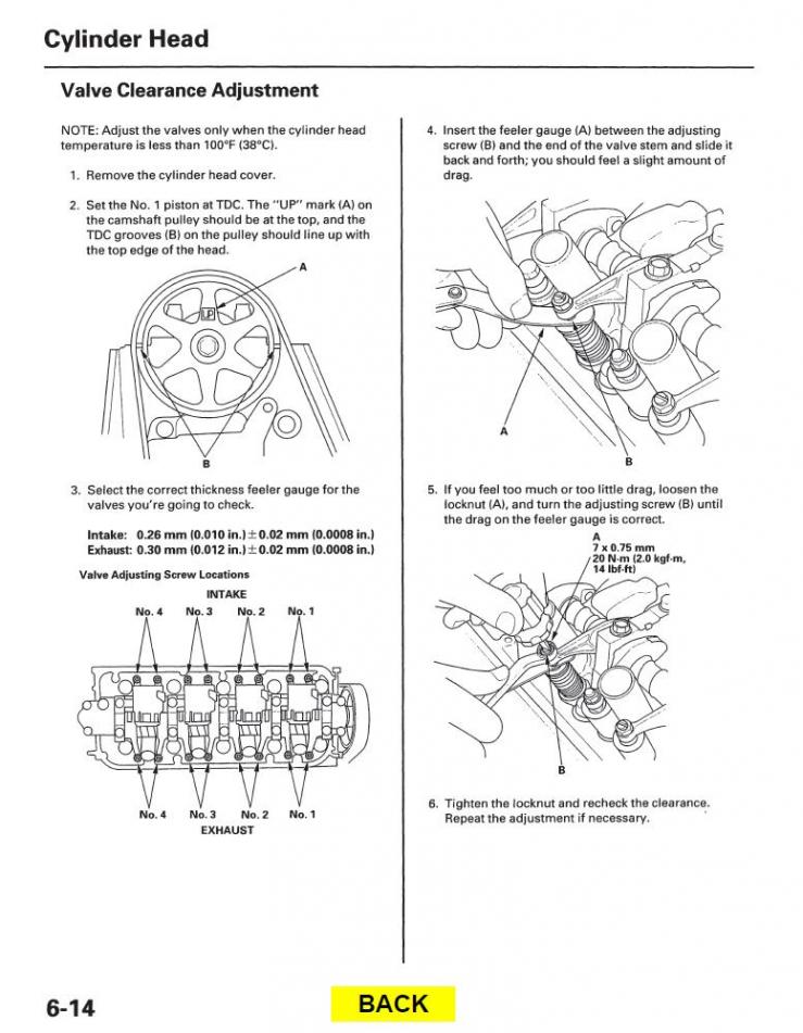

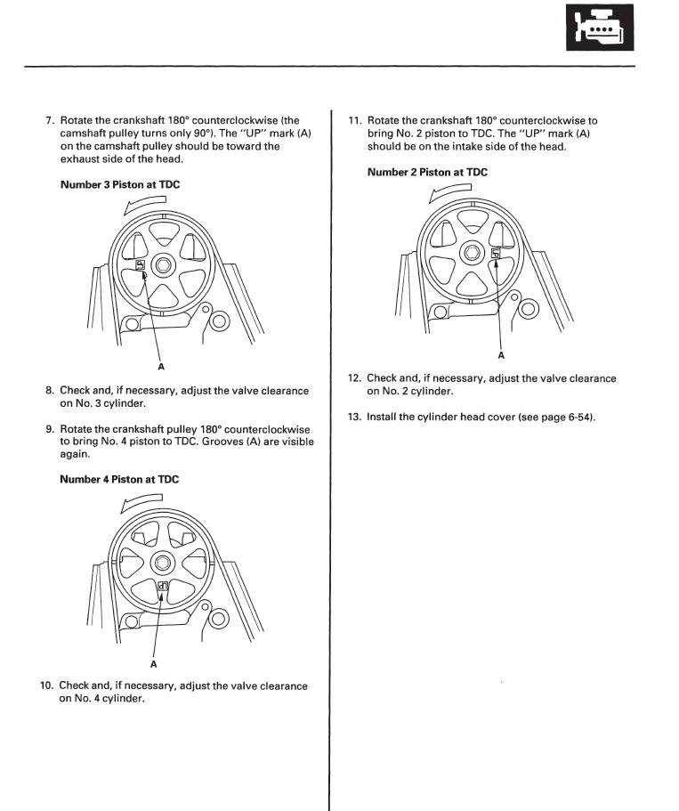

The timing might've been off since it was done back in November the ones who fixed everything said something was off by 3 teeth. But the cam gear came off with the balancer. But not sure when I went to do the valve adjustment, I decided not to due to the fact no timing marks on the PS pully. I couldn't find base lob center on any cyl :-(. That or every single one was way over tighten. There is however a slight noise I can't identify at very very very light gas pedal touch.
Old Aug 29, 2013 | 06:18 PM
The marks are on the "cam" gear. You have to remove the upper part of the timing cover.
See if these pic's help/
Attached Thumbnails 99 accord mis fire/egr issue.-6th-gen-4-cyl-valve-adjust1.jpg   99 accord mis fire/egr issue.-6th-gen-4-cyl-valve-adjust2.jpg
Old Aug 29, 2013 | 06:21 PM
Too add, I'm still worried with the "egr flow" being an issue. I'm just saying that while you have the intake/plenum apart and things off the car, can't hurt to check the valves on #3......and the other cyl's as well.

Ya I know what you mean. Just didn't know the egr flow was that important never owned a Honda nor know much about them. But I plan on doing it this weekend but what I ment with the valves when I went to do them the feeler gauge didn't fit under any of them the. 26 didn't even slide under the exhauste. Which is supposed to be .30 so not sure what was going on so I just put everything back together till I could find physical help lol.
Old Aug 30, 2013 | 08:50 PM
Using an inch-feeler gauge? The 0.30 is millimeters. If your set is marked in inches, it's 0.012 inches, not 0.030.
