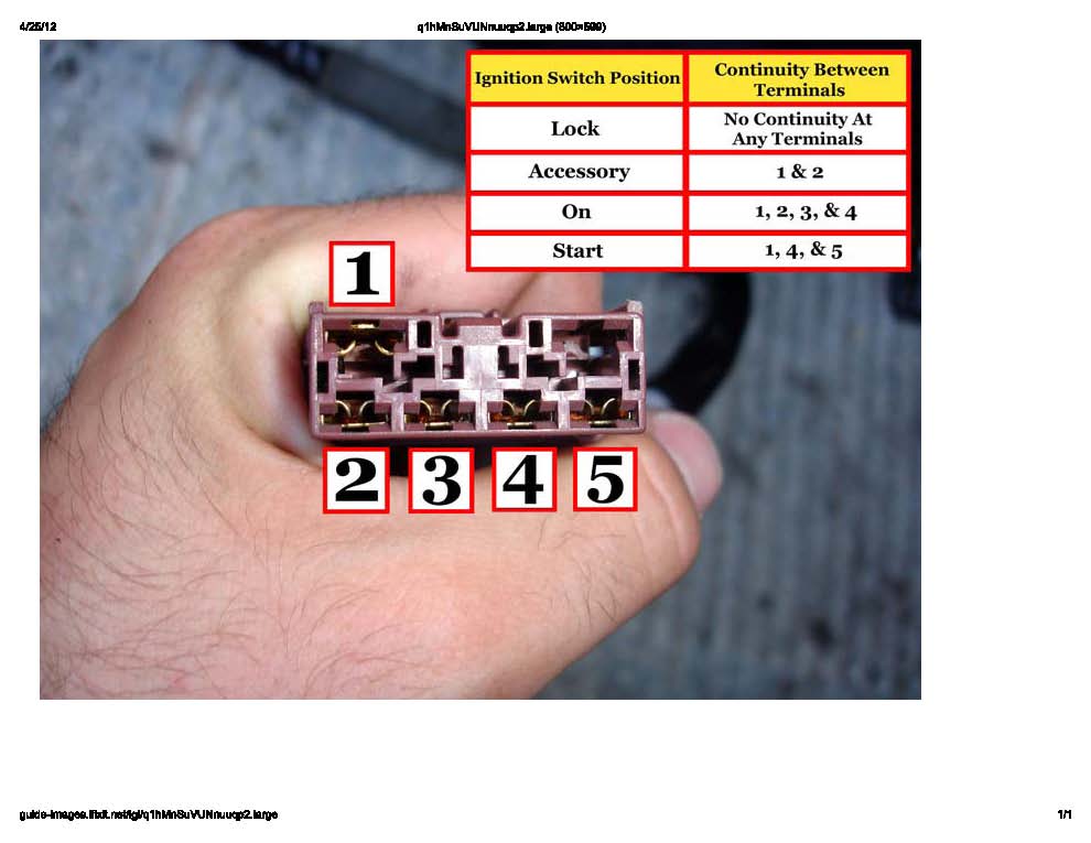

Default Ignition Switch Testing
99 accord v6 cataclean killed my electrical system-testing-ignition-switch.jpg
With Ignition Switch Turned to On, Does this Graphic Indicate Continuity Between:
1. 1 & 4, 2 & 4, 3 & 4
or
2. 1 & 2, 1 & 3, 1 & 4
With Ignition Switch Turned to Start, Does this Graphic Indicate Continuity Between:
A. 1 & 5, 4 & 5
or
B 1 & 4, 1 & 5
Please help.
I find that I get continuity when switch is On, but when Switch is turned to Start, I lose continuity.
Both the old and new ignition switches produce the same testing results.

Old Apr 25, 2012 | 10:17 PM
Posts: 16,334
which graphic are you referring to?
