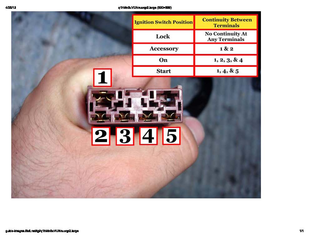

You have to click on the hyperlink: Attachment 6961 in my last Post 278742 to see the graphic. Source: Installing 1998-2002 Honda Accord Ignition Switch - iFixit The ignition test sequence depicted in the DIY hyperlink provided is incorrect.
The correct testing method may be found in this Troubleshooting Guide: How to replace the ignition switch or troubleshoot (Honda, Acura)
When testing the ignition switch for continuity in the Start position, the leads need to be connected to #1 and #2, and then, you need to check #1 and #3.

If you look at the testing, all power to #2 and #3 are turned off when trying to start the car.
If you have an assistant, check that the small wire going to the starter is getting 12V when trying to start the car.

Exclamation Corrected testing procedure for ignition switch
Illustration incorrectly indicates connectivity at 1 & 4, and 1 & 5, when the ignition switch is turned to the "START" position. Pay close attention to the wire colors in the CORRECTION below. Connectivity should occur at 1 & 2, and 1 & 3 when ignition switch is turned to the "START" position.
Source for Correction: How to replace the ignition switch or troubleshoot (Honda, Acura)
Troubleshooting resistance at the harness connectors:
Tools required: an analog Ohmmeter or a DMM and a Phillips and a flathead screwdriver.
1. For your safety and accuracy, remove the negative battery terminal first. (The radio memory may be lost.)
2. Follow the harness from ignition switch to the fuse box. Disconnect the ignition switch wire harness connector from the fuse box. (Alternatively, you may leave the harness connected and take the readings at the back of the ignition switch if you're certain the harness isn't the problem.)
3. Set the DMM to measure Ohm or continuity.
4. With Ignition Switch in the "ON" Position, connectivity should occur when touching the red probe of the a DMM to the clip at the harness connector that corresponds to the large white wire [Clip 1] and while touching the black probe of the a DMM to the clip at the harness connector that corresponds to the black wire with the yellow stripe [Clip 2].
5. Keep DMM probes in same position as in 4 above and turn the Ignition Switch to the "Start" Position, and you should continue to observe continuity.
6. While leaving the red probe of the DMM touching the white wire [Clip 1], connect the black probe to the clip at the harness connector that corresponds to the black wire with the white stripe [Clip 3]. Now, turn the Ignition Switch to the "Start" Position, you should observe continuity.
If you don't find the continuity replace the electrical switch. Re-keying your locks is not necessary.
If you don't find the wire colors as specified on your ignition switch, stop here and consult your service manual.
