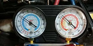

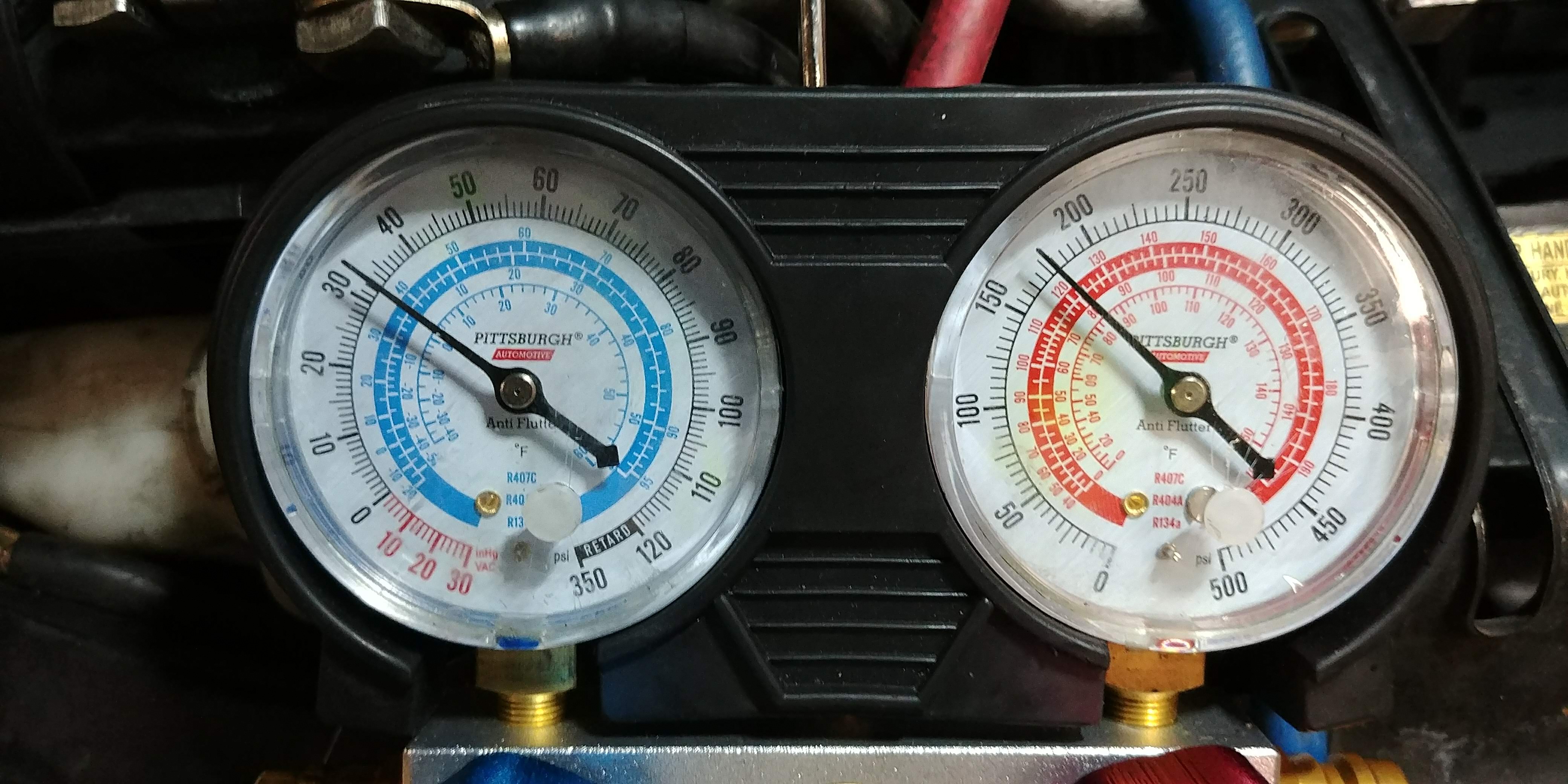

I recently was having issues with my AC getting cold and leaking freon from the low side schrader valve I was like time to refresh the components! Due to the fact I get the components at cost was not a biggie, but now I can't get the car to cool down to where it use to cool to. Before the schrader valve was leaking it use to cool down between 39-44 degrees. I have a mechanical pocket thermometer and a digital one.

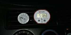

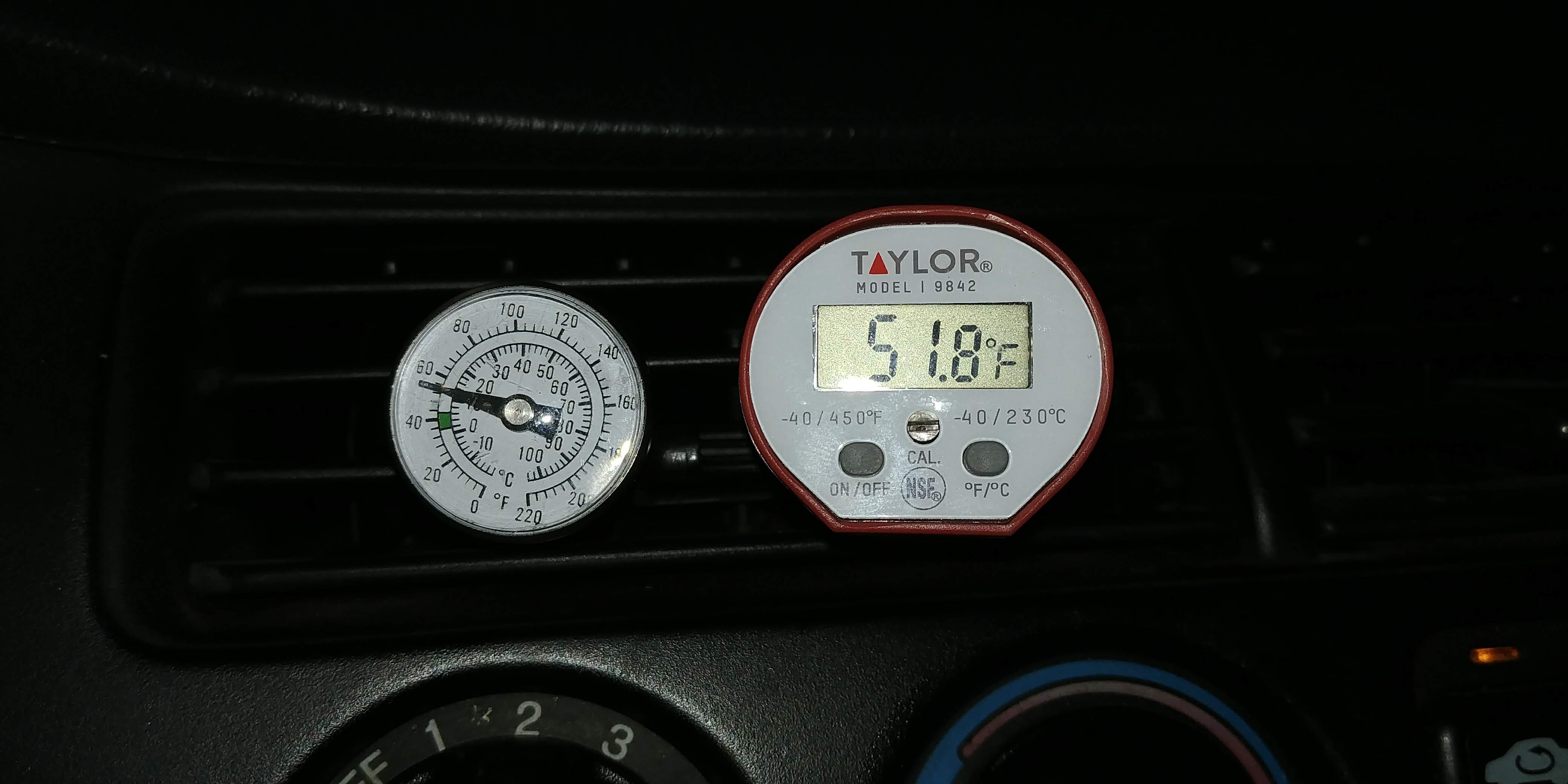

I vacuum the system down to 30inHg and it holds so I let it set with the pump off and gauges closed for 2-3 hours. The system accepts Min 21.02 ounces to 22.9 ounces of freon so I usually charge to 22.0 ounces (I measure with a scale). With the ambient temperature being 75, I should be getting at least 35-45 on the low side and 150-170 on the high side. The temps on the inside vents are 51 degrees. It should be at least 40-44 at this point. Testing the temps on a hot day, about 95 degrees, it only cools to 68 degrees. Once again it used to chill down between 40-44 degrees.

Is the freon can R-134A? Dose the can have oil in it too?
Are those pictures at the end of the post the current pressures?

The can doesn't have oil, just plain jane R134a.
The pics are when it was 80 degrees out.

What is air temp inside car when 51F is measured? In my experience you should be getting close to 40F unless cabin temps are 90 or higher.
Suggest checking whether heater core valve is partially open (firewall on pax side behind distributor). This can warm cool air (controlled by air temp setting ****). See attachment.

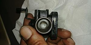

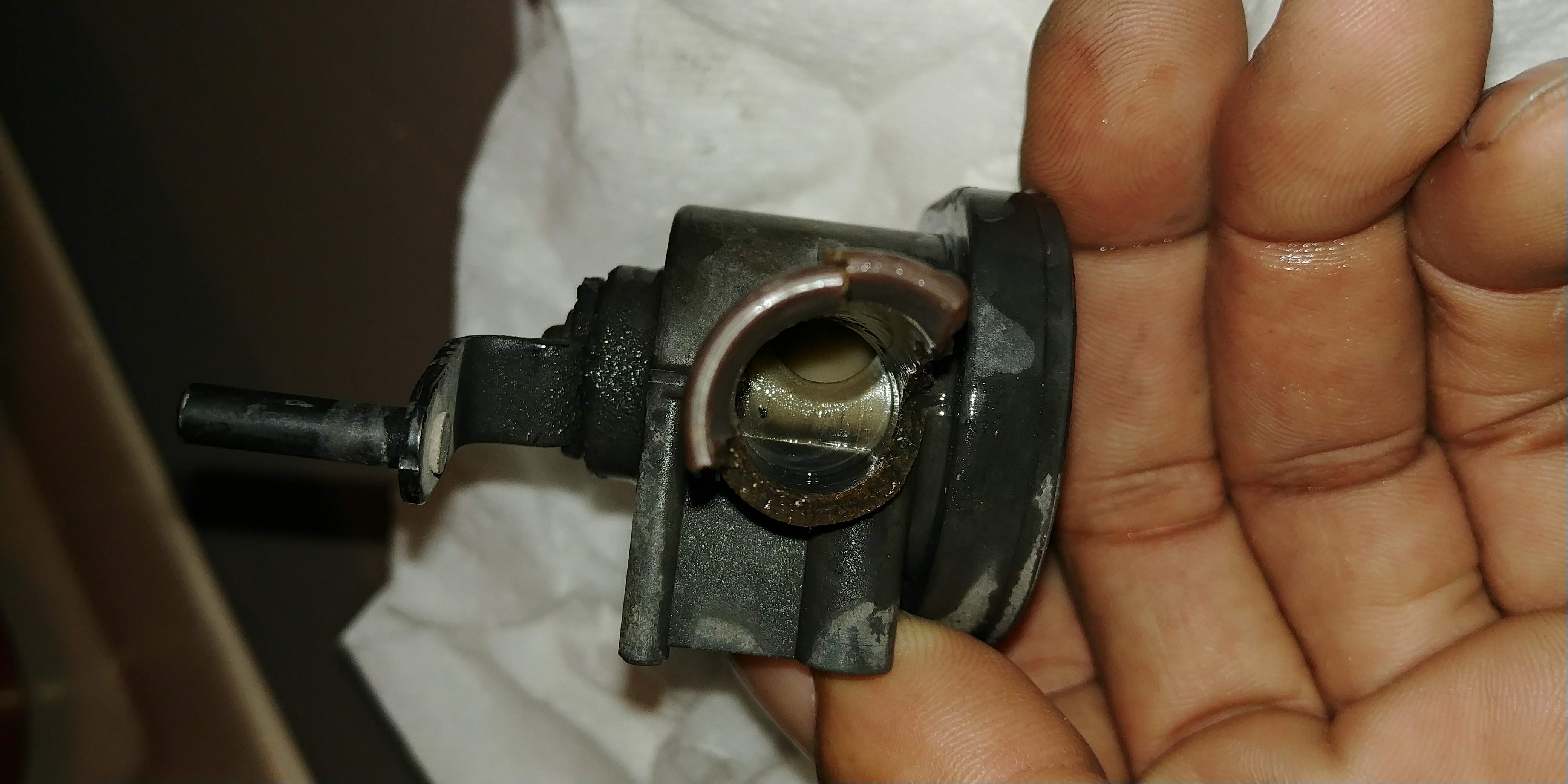

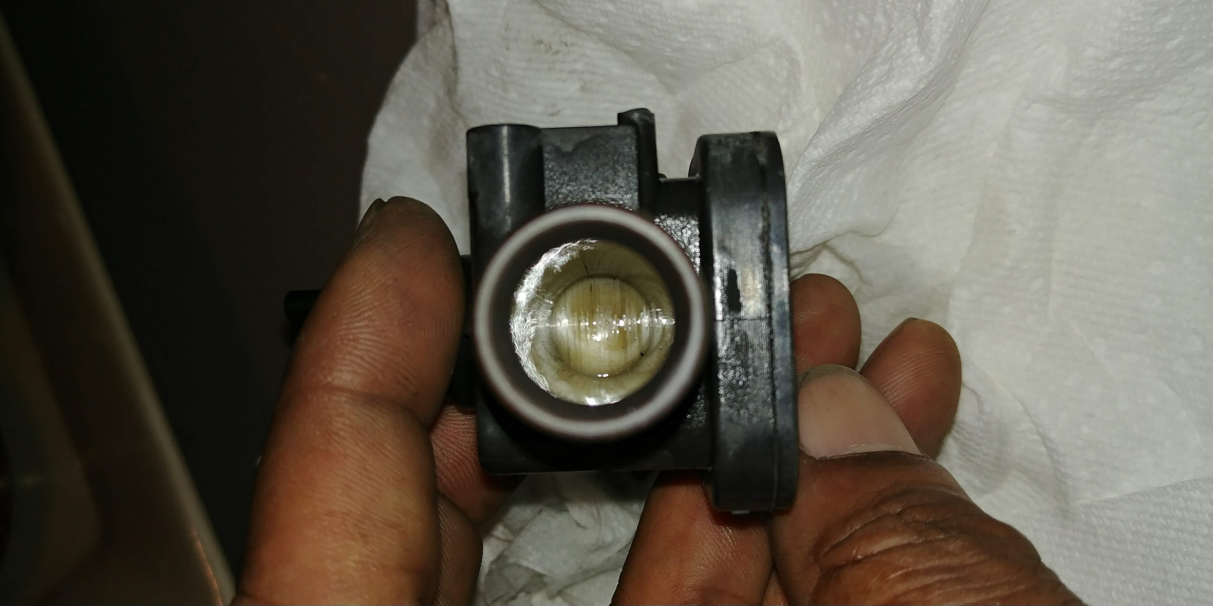

Thanks for the advise.

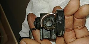

Just pulled the heater core and broke the inlet, but otherwise it was closing and opening normally. I have a spare to throw in tomorrow and bleed the system once installed. Pics are as follows:
1. OPEN INLET
2. CLOSED INLET
3. OPEN OUTLET
4. CLOSED OUTLET
Attached Thumbnails AC help, replaced all major components.-open-inlet.jpg   AC help, replaced all major components.-closed-inlet.jpg   AC help, replaced all major components.-open-outlet.jpg   AC help, replaced all major components.-closed-outlet.jpg
