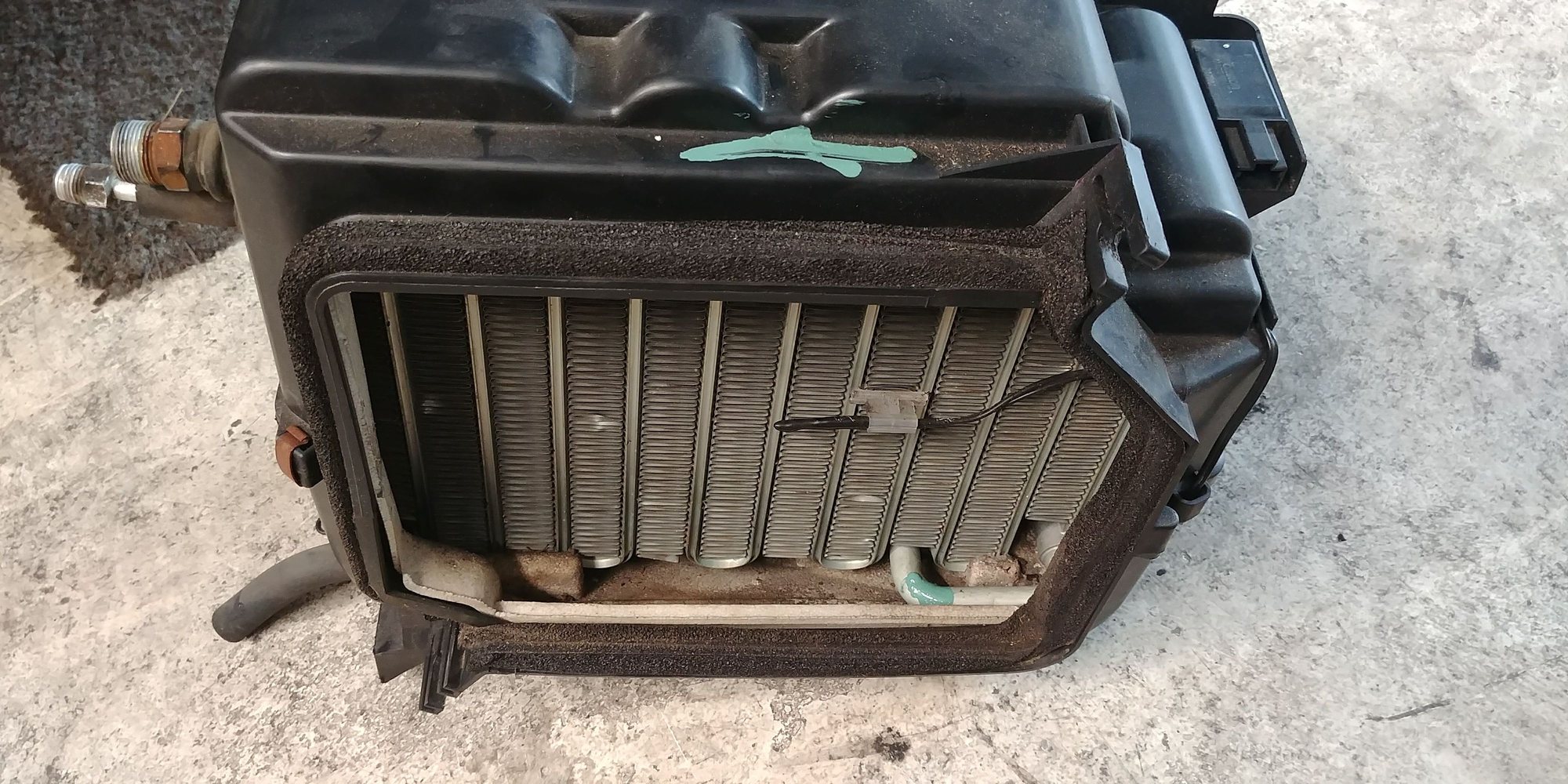

Determined to get this fixed, I visited my local pull N save junkyard and found a clean evaporator enclosed in the case along with the expansion valve. Installed and charged last night with the ambient temps being 77. See pics.

Good work. Glad to see the issue has been resolved.

Yes and I appreciate everyone's help! Not as cold as it use to get but I will take it. If I have to repair and refill again I will raise the RPMs as suggested previously.

The high pressure side looks a lot better than the first pressures you posted. Hopefully you are all set.
What parts did you use originally for the evaporator and expansion valve? I'd like to avoid them if I have to do any a/c work.
Thanks and here are the parts, all from Advance Auto:
ToughOneTXV Externally Equalized Expansion Valve
Part No T39000
ToughOneReceiver Drier
Part No T33574
