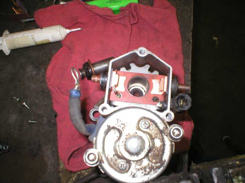

If the starter is just clicking sometimes, the contacts might be worn down.
The cost of replacement contacts is way less than a new starter and are easy to replace in the 'ND' starters.
Here is a pic&link of the starter contacts in an 'ND' starter;
http://img142.imageshack.us/img142/6...contactnf2.jpg
