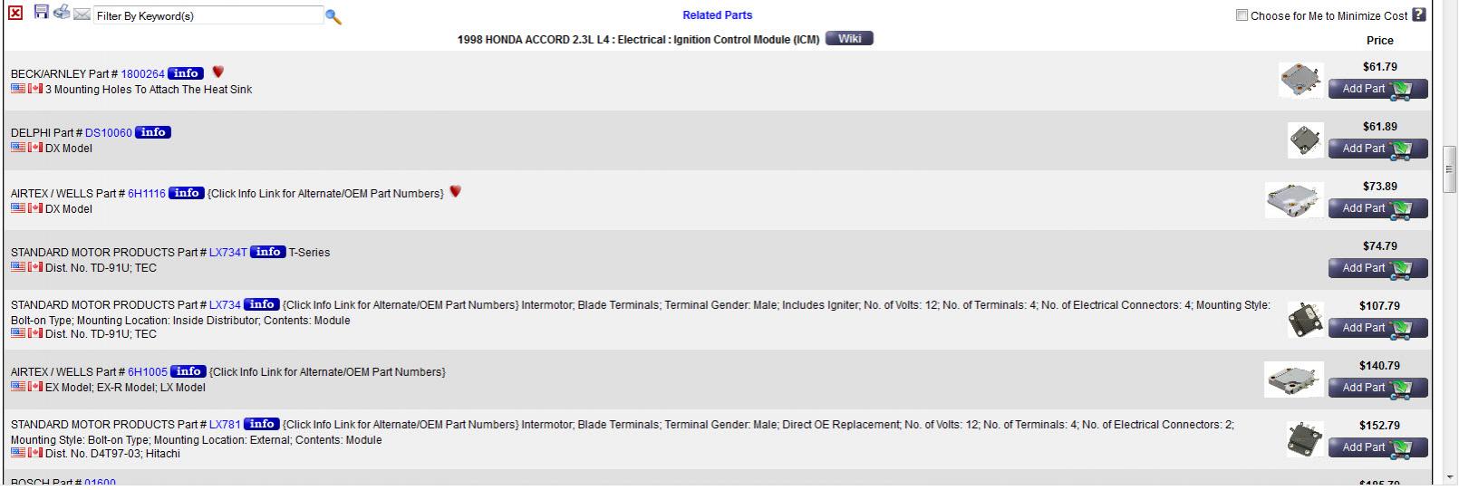

Honda part number for 4 cylinder LX, EX, manual transmission: 30120-P06-005
Aftermarket igniter by Wells:
"http://www.mypartsgarage.com/wells-ignition-module-engine-83.html"

You can see Rock Auto carries even more different brands of igniters for your car, in the attached pic.

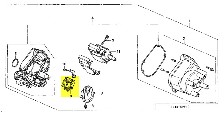

On your 1998, the ignition control module (ICM) is also known as the igniter. Also see this link, "The system uses sensors to trigger the igniter (aka, ignition control module, ignitor or ICM) ..."
Honda Acura ignition (no spark) troubleshooting tutorial - How to

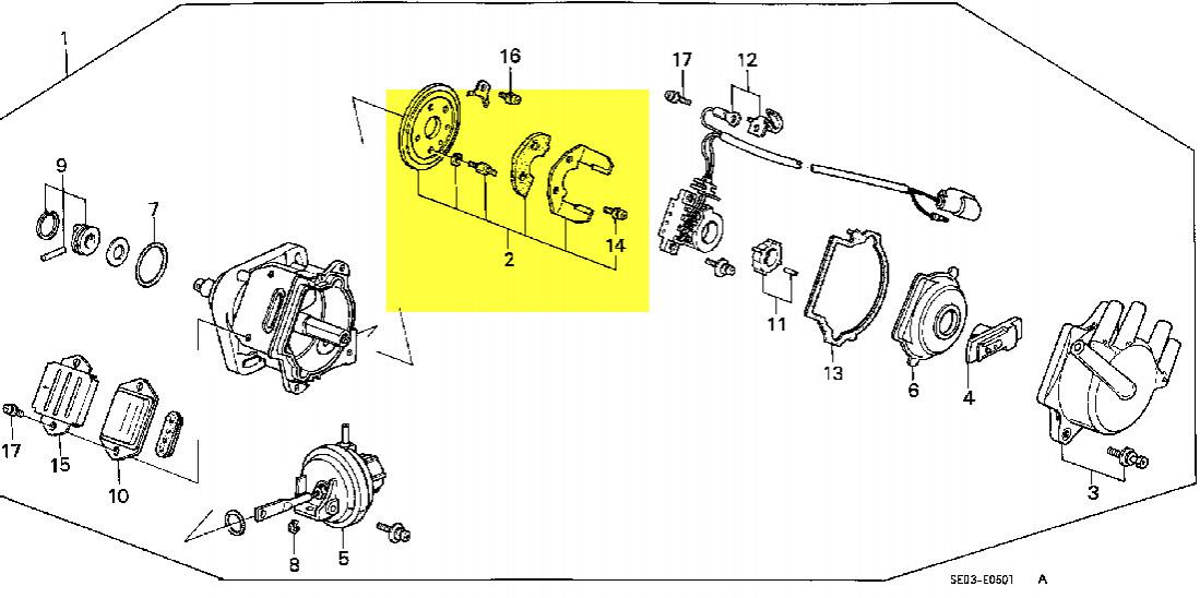

On earlier Accords, e.g., 1989, there was a distributor ignition pickup (breaker plate type), "http://www.dealerdirectparts.com/1989-HONDA-ACCORD-DX-Distributor-Ignition-p/honda-3369346-accord-dx-4.htm" which would correspond to the part illustration attached.
Attached Thumbnails Accord ignition pickup ignitor-1989-accord-distributor-pick-up.jpg

I believe the ICM is different than the igniter. Yes, I've heard the names used interchangeably by some people. Ok if that is true then what is the magnetic pickup electronic module called? This is the item I'm referring and can't be purchased separately except with a distributor. When the ICM is replaced, if the triggering mechanism is bad the still no spark. I can find this item for my 85 Bronco II but can't find it as a separate item for the Accord.... so maybe they do know of what they speak.
Old Jun 6, 2012 | 06:22 PM
Posts: 16,337
The ignitor and the ICM are the same thing.
You are describing the cam position sensor that is built in the distributor housing. Honda only sells the housing and not the magnetic sensor inside.
