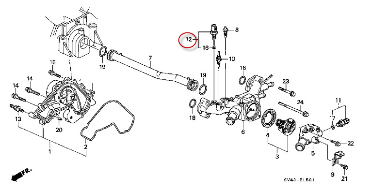

It could possibly be the coolant temperature sensor (#12) in image.

Thanks for the info. How do I go about testing this 2 wire coolant temperature sensor?
You can take it out and boil it and measure the resistance; however, deserthonda's way is easier. See this thread:
https://www.hondaaccordforum.com/for...ead.php?t=5682
