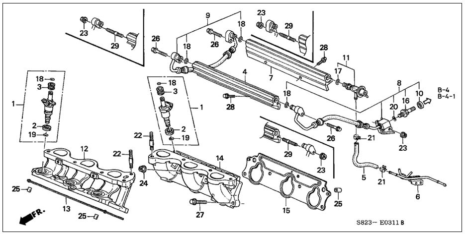

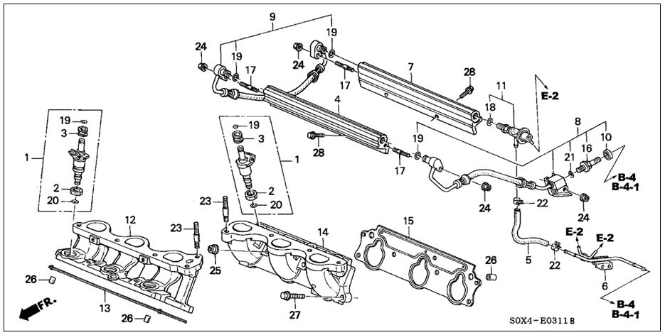

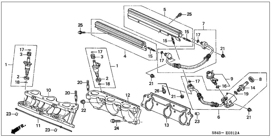

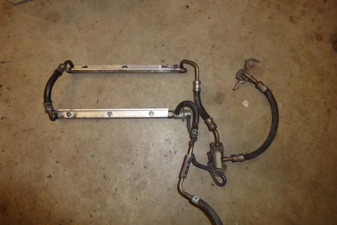

I have put up with the Accord V6 hot soak issue ever since I bought the car brand new back in 2000. Back than, the dealder told me there was nothing wrong with the car. Due to the warmer wether it has become more unbearable.
I came accross a 1999 Acura TL V6 and pulled the complete rails and fuel line without the injectors for only $15 ! I think it had 3.2 V6.
The Acura setup looks identical to the Odyssey and my dads 1999 V6 Accord which does not have the returnless fuel rails.
Below is the pictures of the 1999 Acura TL fuel rails & fuel line. Also there is the diagram of the 1999 Accord V6, 2000 Accord V6 & the Odyssey V6.
Any concerns with using it on my 3.0 V6?
Thanks
