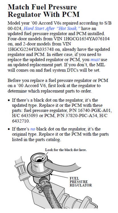

2000accord v6 hot soak (220+ miles). Hello to all . I tried a autozone (2000-2002) fpr to fix my hot soak with no luck, they have 2 different fpr I wonder if I got the wrong one I returned it since it did not fix the problem. Egn is also stumbling occasionally and noticed that if I change the trans position from drive to parkin it helps stayblise. Also have a bad exsaust smell like an old leaded cars. So far I've done the plugs, egr valve, fuel filter, a couple of plug boots, fuel injector add, up graded from 87 to 91 with no improvement at all. Would you recommend I try a fpr from the dealler (a 02 for my 00). I'm considering doing the fuel rails next. I'm not a pro just a do it your self guy or should I a pay a pro to get fuel rails done, still not sure of all the parts I need to replace them if I do,do the fuel rails .........please help I'm in riverside California (eastvale) if any one near and can help I will come to you!

Here's a little more info. regarding the Honda fuel pressure regulators.
