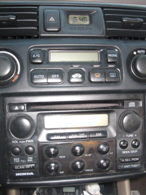

Here are some photos if they help.

All of my buttons work. Every light comes on that is supposed to.

I think that your car is an EX.
My guess is that either the mode control motor or the actual control unit is not working. I don't have a wiring diagram for your accord, so I can't give you very specific instructions on how to determine what component isn't working.
The mode control motor is what opens and closes the vents based on the setting that you enter. It is under the passenger side dash and may be a pain to access.
The mode control unit is what you showed in the picture and switches power to the mode control motor to have it change positions.

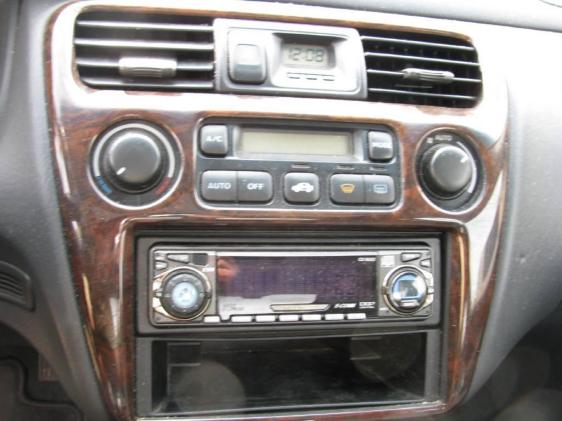

Thank you for your help. At least I know what I am searching for. Do you know how I go about troubleshooting to see wheather it is the motor or the control unit? If it helps, I don't believe I ever turned into to strictly feet before it started acting up. I got into my car yesterday morning and the setting was on the top vents but the air was just blowing through the feet. So do you think this means more than likly it is the motor?
