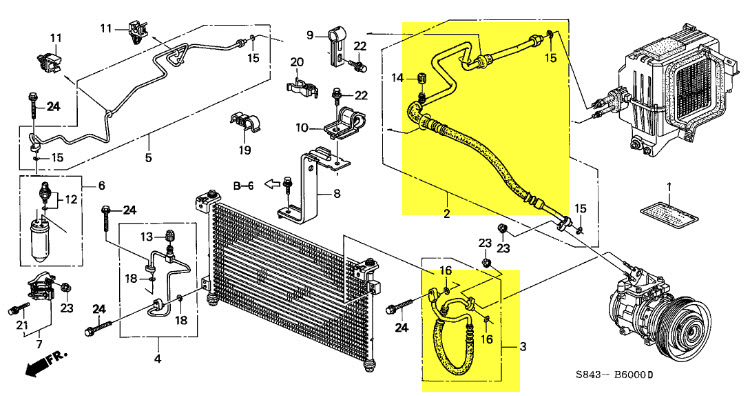

I need help finding where I could buy one of the hoses for the A/c system.
In the Haynes manual it is referred to as the "Receiver Line". This Hose Goes from the firewall to the receiver-drier.
Can someone please help me locate it online/@autozone/@oreillys website. I have these 2 hoses A/C Hose Assembly | 1998 Honda Accord LX 4 Cylinders 2.3L MFI VTEC | AutoZone.com
But I cannot get my hands on the 3rd one I mentioned.
Old Jun 6, 2012 | 06:30 PM
The line from firewall to Receiver/Drier is not a hose, it's an aluminum tube. See any of the Honda parts sites (Majestic, etc). It's called receiver pipe and cost about $35.
You can probably find a used part via ebay or car-part.com.
Old Jun 6, 2012 | 06:52 PM
TexasHonda is correct. You already have the two hoses shown in the parts diagram (pic. attached).

Awesome! Thanks guys. See I had no idea what it was hose / or just a line since I bought my car without those.
