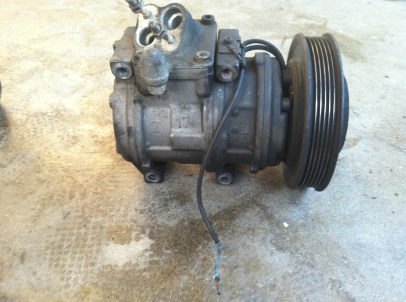

I did remove the compressor, I was spinning it and it felt very smooth. No grinding or unhealthy noises coming from it.
What is "Clutch pulley should spin w/ smooth rotation on idler bearing. " ?

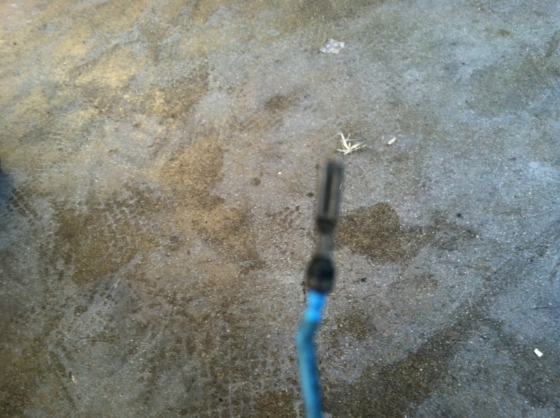

Where do I direct the 12v to? To the wire coming out from it?
And how do I confirm that the clutch coil closes the clutch plate?
I apologize for all the questions but this is a part in the car I've never worked on.
I will look around for the orings from ackits.
I forgot to mention, was there a certain 'drain plug' to drain the oil in the compressor or was any oil that was in there supposed to drain out of the ports where the hoses connect?
Nothing drained out where the hoses connect, it was bone dry.
Response: Did you spin the clutch face (inner part which is separate from the outer part (clutch pulley). Plate pulls in to connect to pulley and turn compressor. So when you turn the clutch plate you're turning the compressor. When you turn the clutch pulley, it's rotating on an idler bearing.
Response: To the wire coming out from it? +12V goes to the single wire. You will also need a negative path (ground return) connected to the compressor body.
Response: You will see/hear the clutch plate slam against the clutch pulley. If nothing happens, the clutch gap is too large or clutch coil is failed open.
Response: No, there is no drain plug. Removing old oil requires the flushing w/ air or air+solvent (laquer thinner). If there is no evidence of compressor debris, I would suggest using a small amount of laquer thinner to clean hoses and condensor. Evaporator is more difficult to clean, but a small amount of laquer thinner would clean any old oil. Many pressurize/pop release fllushes are required to get all laquer thinner/oil out. When you vacuum any residual laquer thinner will evaporate.
Response:I would still flush w/ air+solvent to clean them since they may have been open for a long time.
