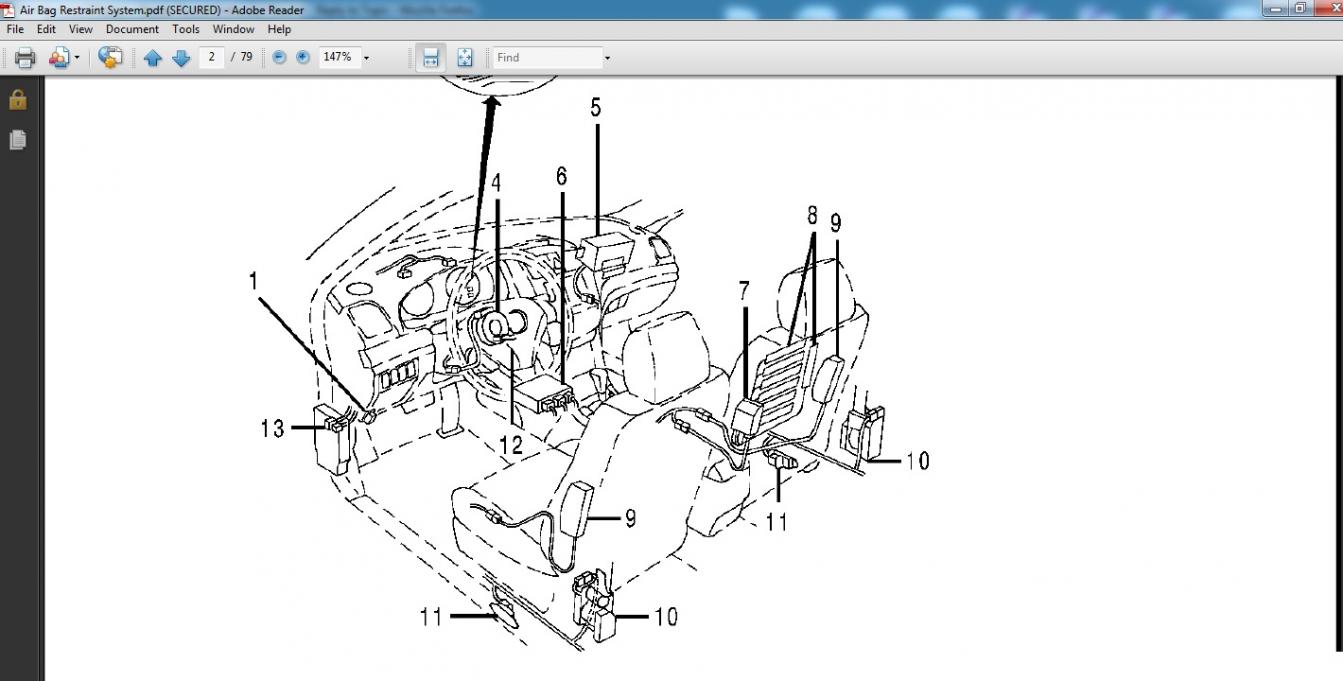

I downloaded an 03-08 TSX shop manual, and the MES looks like it is plugged into the fuse box. It is number 13 in the attached pic. It should be plugged into a dummy connector (no pins leading to it).
This may or may not be the same setup as your accord.
