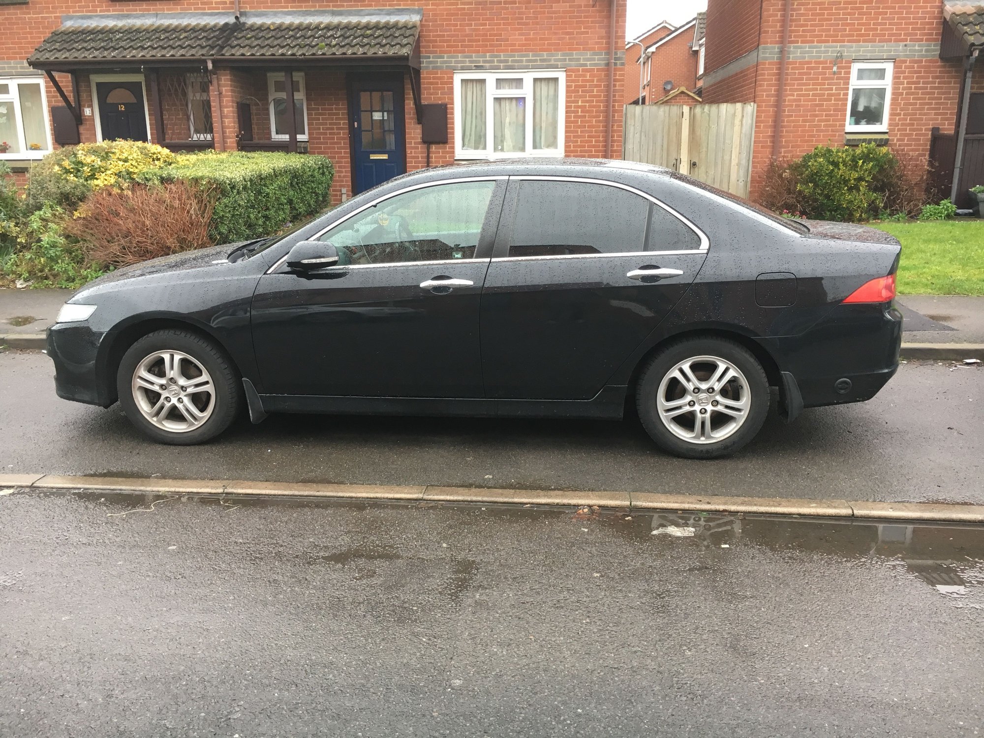

hi, I am in UK, this is what the car looks like. Hope this helps. Thanks
