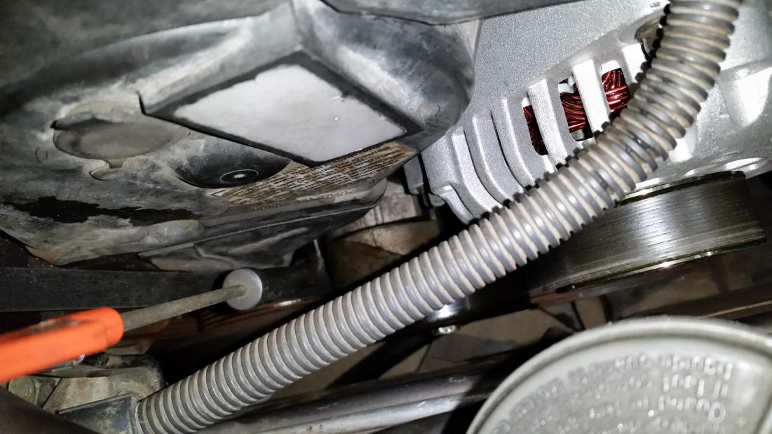

Old May 15, 2014 | 10:45 PM
It could be an issue with the alternator; but, check the belt and tensioner.
  • Where does the auto-tension indicator point with the belt installed and car off? Does the pointer move around with the car turned on?
  • Look for problems with the other pulleys.
See link:
Belt tensioner

Attached is photo of tensioner marks.
Attached Thumbnails Alternator replaced..but with side effects-20140516_011630.jpg
