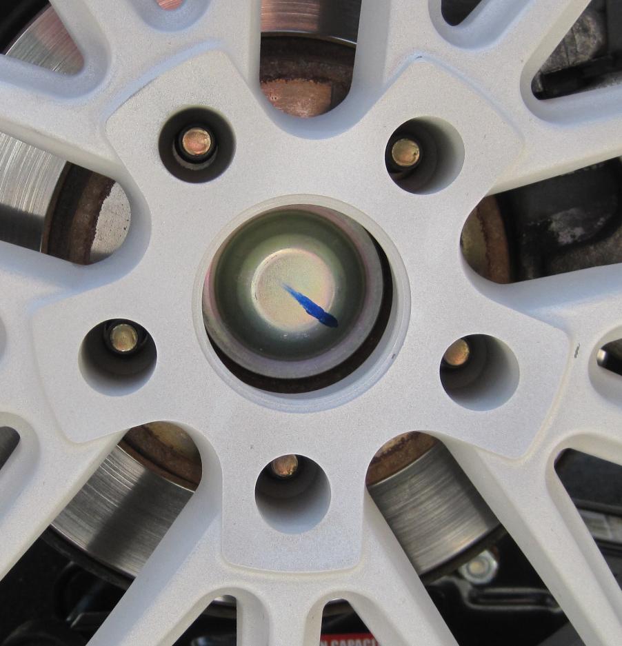

ill post a couple pics i took

I do not have lugs.. so i couldn't center the wheel perfect. It appears the lugs line up thru the holes perfect.
i called Discount Tire online and they are sending the hub centric rings. I guess I will wait and put the rings on and see if the space in the hub fills in. They said they have the rings for my car and that wheel.. weird???

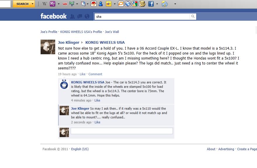

can this be true then????

It looks like the 5 x 100 are closer to the center than the 114 would be. I doubt you could get all the lugs on without bending some studs. Did you try putting lug nuts on? Some aftermarket wheels are slotted, so they will fit more than one lug pattern, but these don't look like slotted wheels.

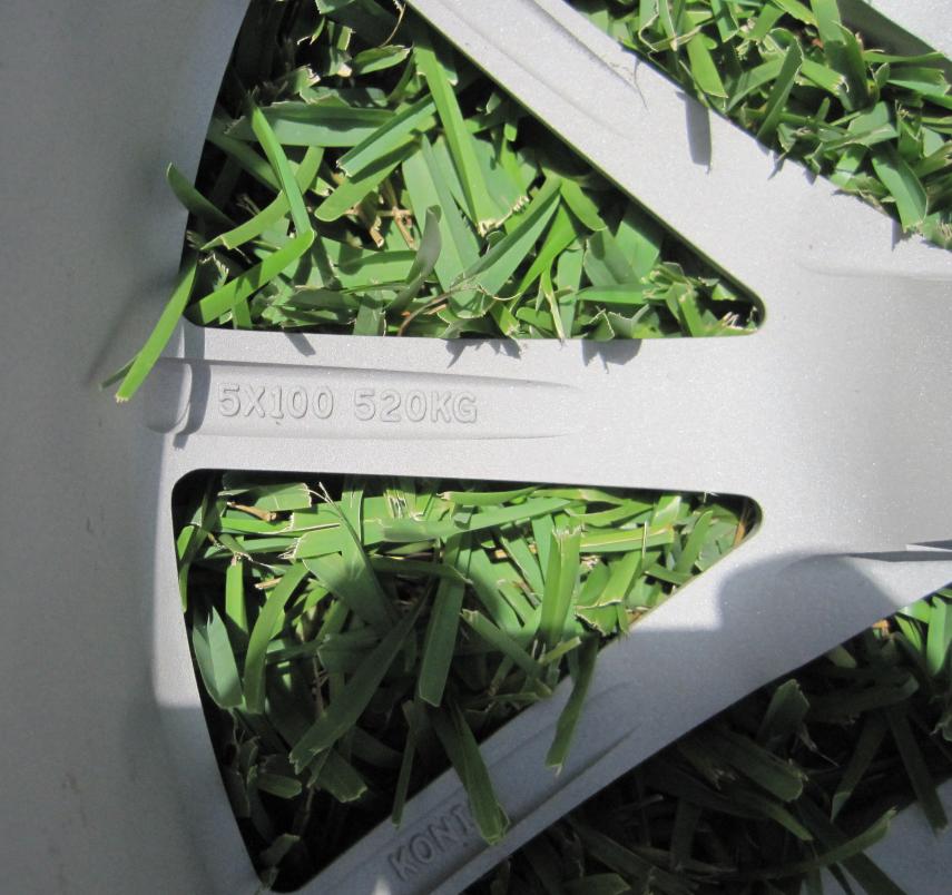

I have the hub centric rings coming this week.. Lugs will be here next week.. before I go get them powder coated I will check and see...
The guy I bought them from said he had them on an Accord.. no problems..
Konig says they will fit.. I just find it really really odd...
noone will give me an answer weather they have tried to put a 5x100 on a 5x114.3 hub to even see if the lugs did align.. so I will give it a shot..

another reply
