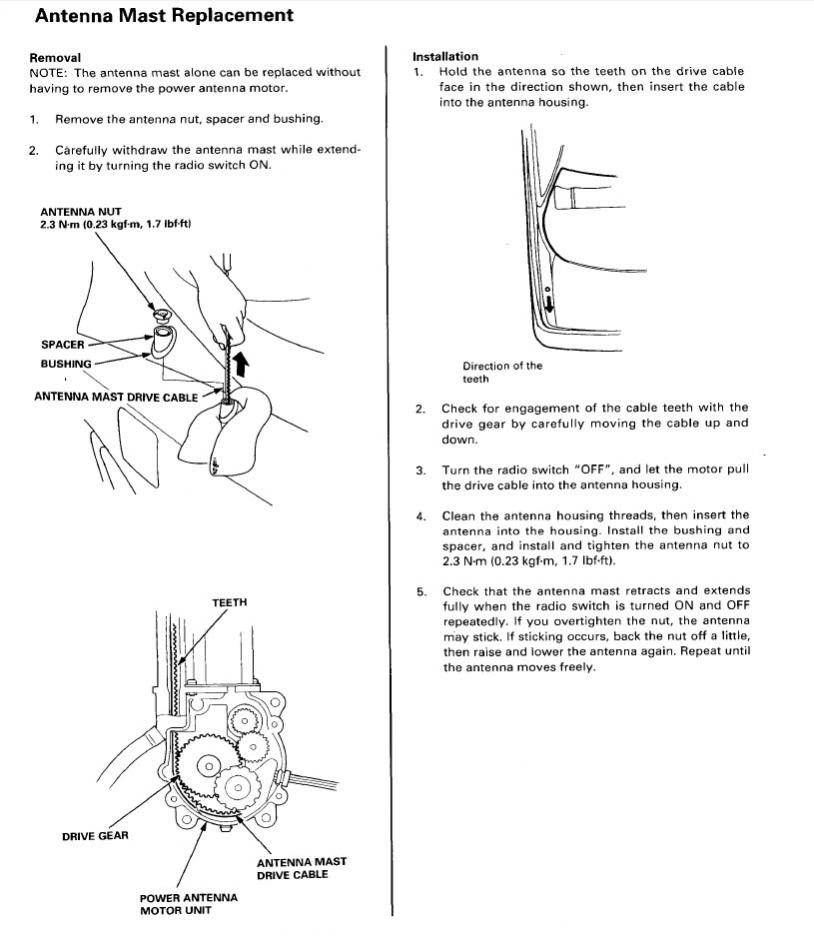

It may be the antenna mast needing replacement due to broken teeth.
Sometimes, in a few situations, the motor housing needs to be opened up too to dislodge some of the broken teeth.
