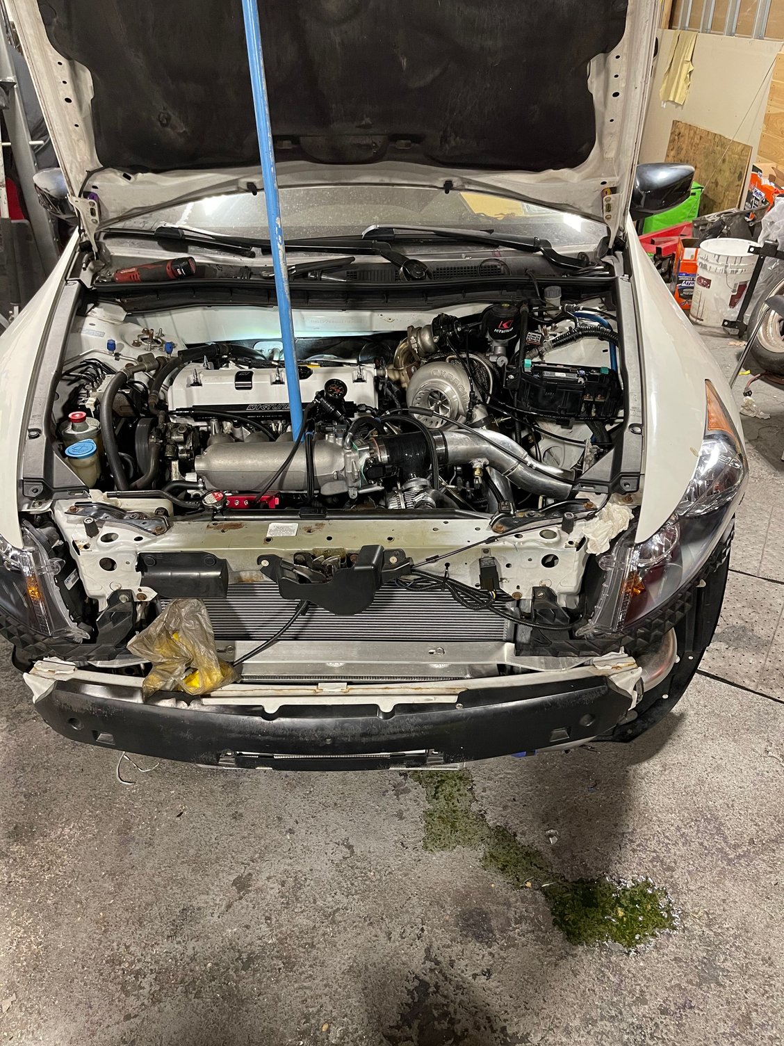

Hello All,
I have a 2008 Honda Accord sedan ex and I decided to do the unthinkable!
k swap it.
I currently have a k24 tsx block with a k20 head** Turbo!
problem is the passenger side axel (stock accord axel) does not seem to be long enough to fit the setup. My question is can I try to get an rsx type s axel and is that longer than the stock 8th gen accord axel. It’s a one of a kind build and this is the last piece. The rsx intermediate shaft is 2cm shorter than the k24 accord I had in in there so the accord axle is shorter I need the rsx axle which is the longer of the 2 axles Please help

You have a unique request for a unique build, so hopefully someone on here knows the answer.
My advice is to either reach out to a reputable aftermarket company to get the length of the CV joints. See if an autoparts store stocks CV joints for those vehicles and measure them. Find a u-pull-it yard and measure the CV joints.
