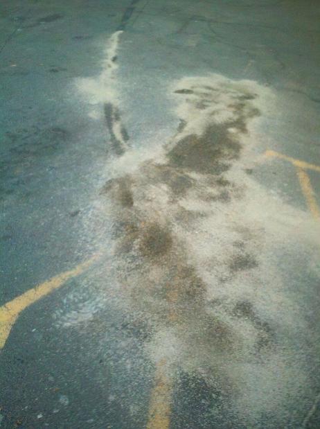

A few weeks ago, my balance shaft seal popped out of the block while i was warming it up before leaving work (10 degrees out that night)
I pulled out of the parking lot, engine sounded normal, and a coworker called me a minute later telling me I had left a puddle. All the oil drained out in 15-20 minutes, but the low pressure light never came on. Took about half a bag of quick dry to cover the spill.
