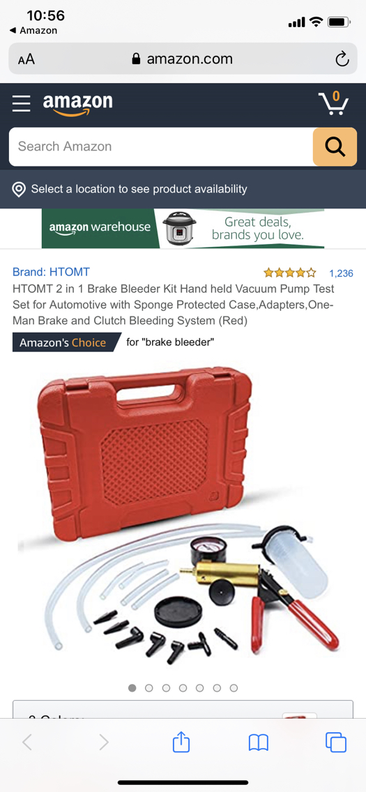

Seanjordan, thanks for your response. The Amazon link you included resulted in a blank page. Can you indicate the full product name so that I can search on the Amazon site?

This is it

Sean, thanks for the screenshot. I was able to locate it on the Amazon site. Is it true that if you use a brake bleeder kit, you minimize the chances of air entering the system?

Yes it is but there's other things like getting a tube to put over the valve and do a self bleed. But a kit is the most common way to achieve bleeding without introducing air
