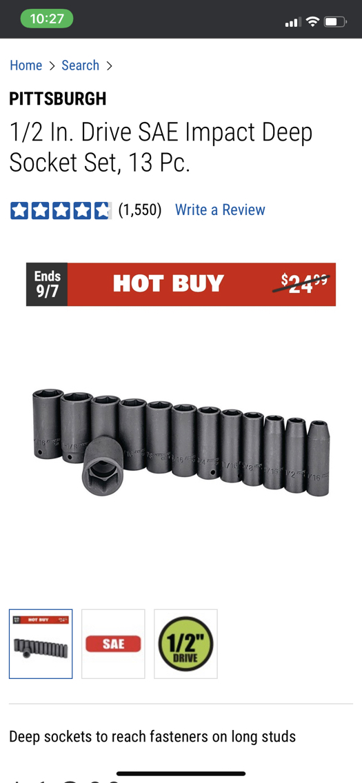

Yes the battery and charger you have to buy separately. If you search it without the B at the end of the model number it comes with everything. I just like buying bare because I have chargers and batteries already. You can find them cheaper on eBay if you want to. You can use any sockets but I would advise you to go to Harbor Frieght to get a cheap set of impact sockets. They are $20 until 7 Sep. regular price is $25
