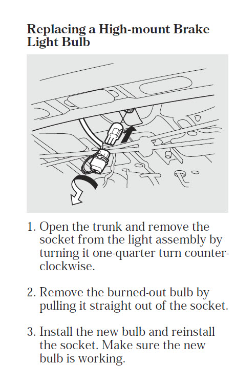

Thanks, guys! I will check the passenger side bulb tomorrow. Also, how do I acces the center assembly? I've never had one of those burn out on me before.
Old Feb 15, 2017 | 06:40 PM
Posts: 7,101
The following are instructions for the high mount and rear bulbs.
Attached Thumbnails Brake Lamp fault light/ center and right side brake lights out-high-mount.jpg   Brake Lamp fault light/ center and right side brake lights out-rear-bulbs.jpg
