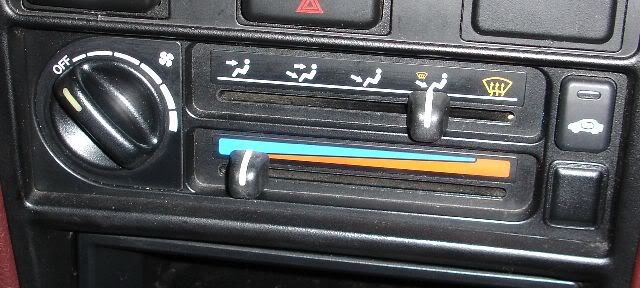

Does your heater control look like this?

yes thats wat mine looks like
