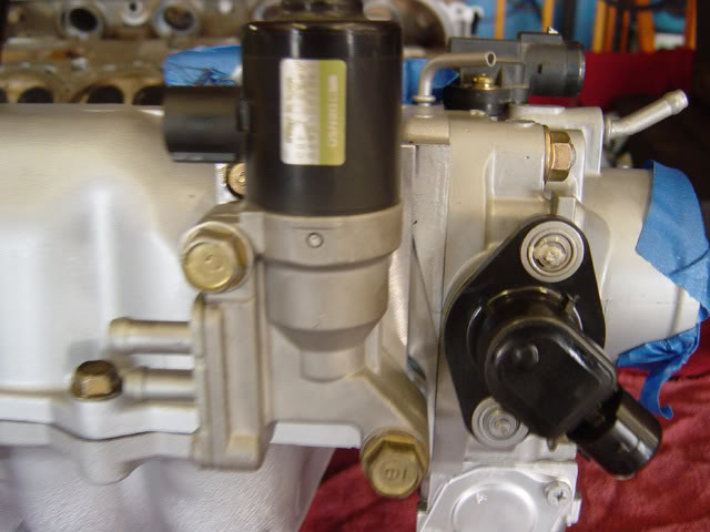

Originally Posted by RobinsonRicer
I was wondering about the location where the IAC has coolant pumped through it. I had to cut the nipples and then hold them with hose clamps cuz of the TPS. But coolant wouldn't be getting into the engine at the IAC like that.
Sounds like you did it exactly right but just to double check, the IACV was installed with the coolant lines right next to the TPS:
...not this way:
Upside down - the second pic - would pump coolant into the throttle body, intake manifold, and cylinders.
Which IACV adapter did you use?

Yeah. I actually used the instructions from the write up that came from. So I flipped it and cut the nipples back. Its a bit of a squeeze but it was enough to allow the coolant to run though. There were no leaks under my car this morning so I figured that everything had held together. It was just the sweet, white smoke that would not go away all last night. But there was none this morning. the car warmed up a little but it was a short drive to the mechanic. If coolant was crossing into the engine through that connection would it happen immediately or would the car have to warm up first? Thats the only spot I could imagine coolant would get in without any cracks in the head.
The adapter was from rosko racing.
