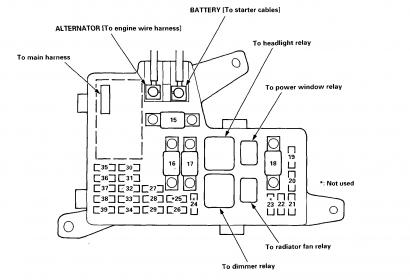

,, first off chk the fuse # 34 , 15 amps under hood fuse box,,,(that fuse power cond fan relay and compressor clutch relay ),,,make sure that fuse is good,, key on position,, chk power at condenser fan motor ( driver side of car ) you should have close to 12 v on the blue/yellow wire and should be ground on the black wire .......

Made a mistake reading the wiring diagram. Desert is correct. Check that #34 fuse. See if you have 12V on one of the two pins of the correct fuse when the key is in the II position.

I'm making progress. Unfortunately, I didn't have much time to work on it over the weekend. I double-checked the fuse, and it's good. I also checked the pins. I do have 12V on one of the two pins of the correct fuse when the key is in the II position.
